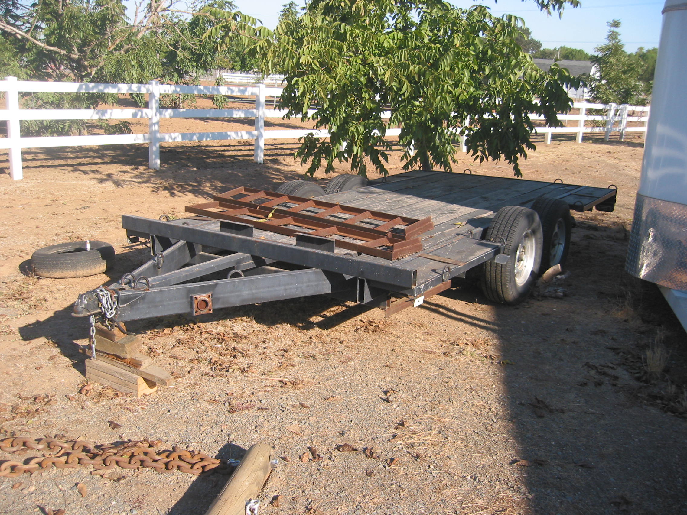

I got a 18' dual axle wood deck trailer for $500 and plan on spending another $500 for brakes, fenders, paint and miss. to make it pretty nice.
