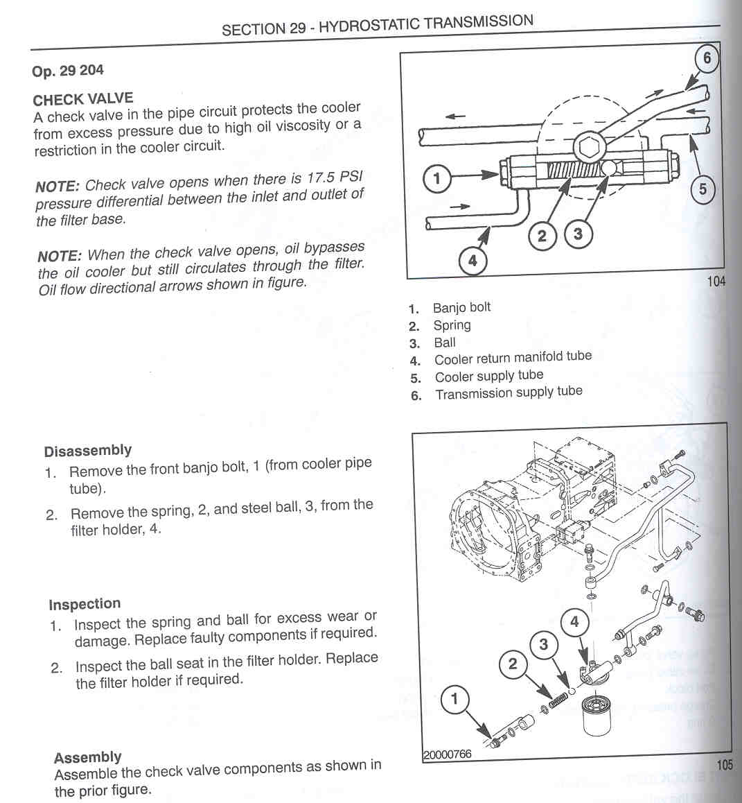

I have a new TC40D. I notice that there is a repeating noise that comes from the area of the hydraulic filter on the left hand side that sounds like (and I apologize in advance) "pth, pth, pth," etc. - almost like an exhaust leak, but not as loud. Is this normal? - just hydaulic fluid coursing through the lines/filter? - maybe I have air in the hydraulic lines(?). Everything operates absolutely perfect and I have detected no leaks of any sort.

Pat, there is a spring loaded ball valve in the assy. the filter screws into. This is the inlet filter for oil coming from the sump and going to the hydrostat, and I believe the valve is a pressure maintaining valve, so when you are idling, it doesn't stay open constantly and you are hearing the "pth" sound when there is enough pressure to lift the ball valve. Beyond that, I can't offer much, but there was anothe thread about this awhile back and you are one of many people who have noticed the sound. My hearing is weak, or I probably would have heard it on my TC45D. I have the illustrated parts catalogue which shows this valve. It doesn't say what it is for. Inthe hydro section of the maintenance manual I have not yet discovered a complete description of the valves operation. I think you can take Hawgee's advice and relax. Just think of the sound as indicating everything is working right./w3tcompact/icons/smile.gif

There seems to be so much interest in this that I will post a scan of the illustration and any description I can find; probably toward the middle or end of the week. Once it's posted, we can just link someone to the post at a later day. I'm sure this is going to be a recurring question. Just be patient, I'm a little old and slow. /w3tcompact/icons/frown.gif

Duane and all, lets give this noise a name. The valve on the top of the HST filter is the HST Cooler Check Valve. If this is what is making the noise, it must be because the oil is not hot. According to the Repair Manual (see attachment) the valve opens when there is 17.5 psi of pressure across the cooler. This would be because the oil doesn't need cooling (I think). I hope this clears up the "phantom noise" problem.

Jinman - that is the most logical reason I have heard or seen for the noise yet. Makes perfect sense.
Pat - don't worry about the noise as others have said it was the subject of ealier posts & it is normal.
