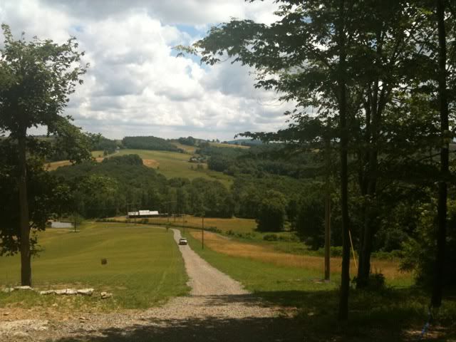

I understand that this has been a very mild winter, I'm told I need to get prepared to move lots of snow. I'm up in the mountains near ski resorts and such. I have about 1/2 mile of gravel driveway between me and the county road, parts of it are pretty steep.
I'm planning on getting a Kubota B2920, with a front mounted blower, loaded R-4's with chains and I will have a rear blade for days when the snow is not deep enough to blow.

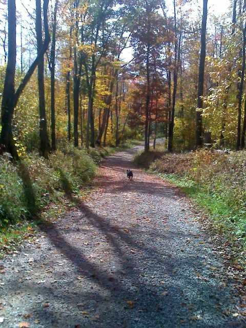

I know it's hard to tell how steep the driveway is in the pictures, but the second picture is a 2-wheel drive 1/2 ton chevy pickup. It's from the first day the wife went out to the house, that's as far as she could make it up the hill.
I have since upgraded her to an AWD, and one of the boys drives the truck now. He can make it up the hill fine (with several hundred pounds of ballast in the bed) when it's not snowing. But if it's snowing or icy he has to park down by that light pole.
