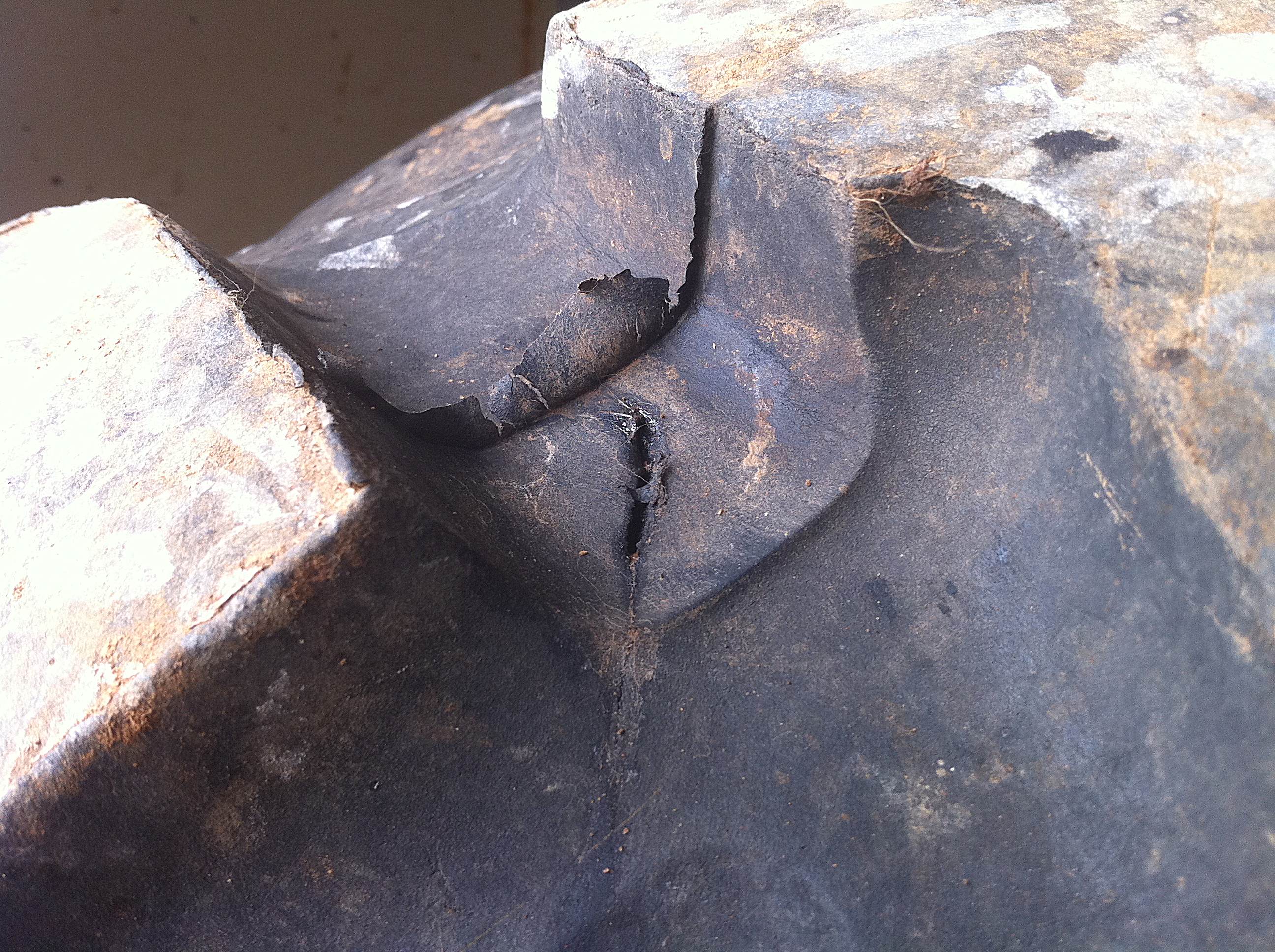

The length of the gash is 1 inch. I can see water coming out of it.
Can I patch it using the coventional method or patch it from the inside?

I would check on having it vulcanized.

I was afraid of that. :(
It's going to cost me around $300
$80 to come get the tire
$80 to come and install it.
$150 to vulcanize it....
This sucks...
I have to think twice next time when I let my neighbor borrow the tractor.

Is all the way through? What size tire?

why not post the pic so it's easier to see.... i'll do it for ya.
now.. that said?
me? I'd tube it and stick a patch on the inside to protect the tube.
bet it costs you less than 50$ for the dismount, patch, tube and remount.
or 30$ if you do the work yerself.
I always use a boot or patch on the inside of a tire to protect a tube..

Where do you live? I have to agree with Soundguy. I'd have someone come out and put a tube in the tire. I'm thinking in my area it'd be close to $100 for the call and tube, but I know it wouldn't be $300.

I don't have the experience most of the folks here do, but....
I would try tire plugs first - no downside if it doesn't work...
I have plugged gashes that size in vehicle tires in the past - once even in the sidewall (not very safe I know - but young and poor - had to make do). I was always surprised how 2-3 plugs in a row actually worked. I would assume results would be similar with a tractor tire
The other suggestions would be the proper fix - but may be worth shot...
