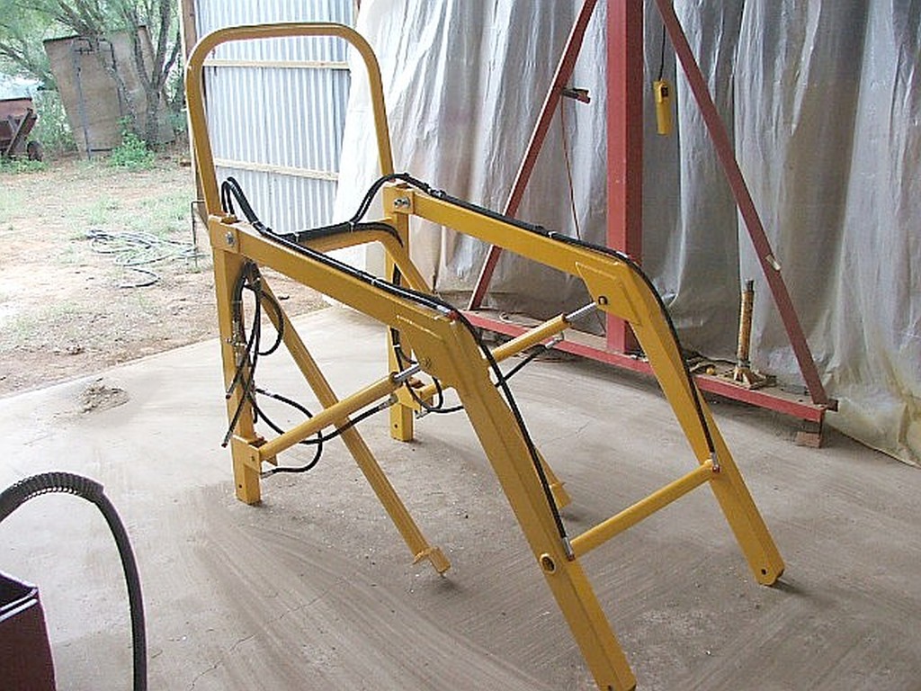

The ROPS for my Kenbota is in the middle. I made it part of the FEL assembly.
Please don't mind the dirt. I only did a "quick sweep" for the picture. :eek:

Your ROPS is better than the machine with the skinny wire loop!
PS, a dirty floor like that means, somebody is working! :thumbsup:
