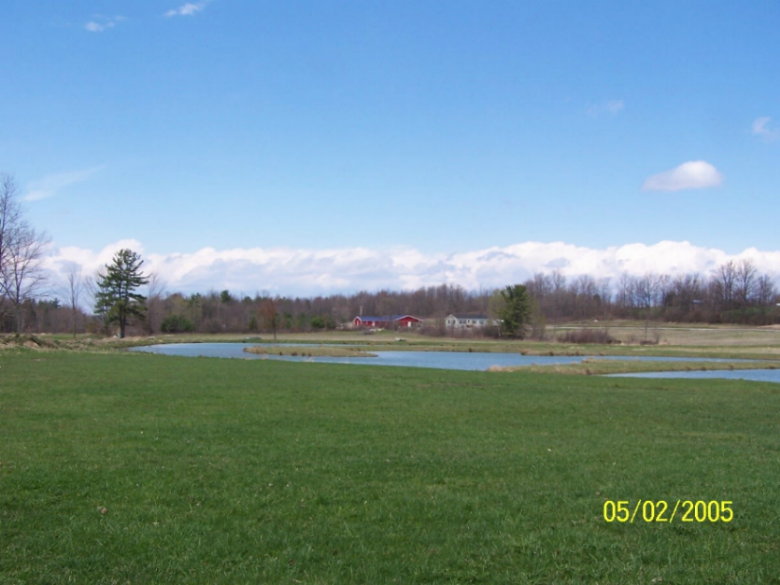

I also have another question will a front mower enable to mow right down to the waters edges on the ponds in this picture? My arms almost fall off in the summer from weed wacking around these ponds I like to keep it very short for dog training to be able to see the dogs in and out of water also by keeping the shores cut the muskrats do not have as much place to hide. They can make a mess of a shoreline!

Whether you can get in there depends on your climate and soil conditions right beyond pond. But the Toolcat's front lift arm with a front near-finish mower or a rotary brush cutter does allow you to easily cut areas that would be difficult to reach with traditional tractor setups. I'd think you could use Toolcat for much of cutting work near your ponds, especially since the slopes don't look very steep in your picture.
