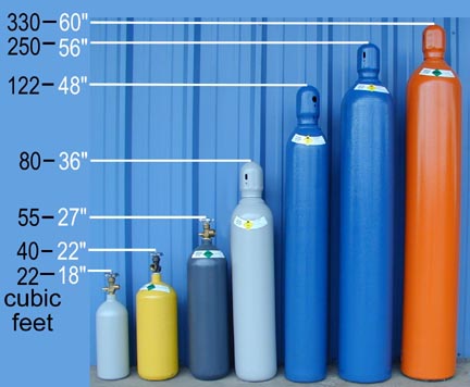

Tank sizes.

Shield Arc
Do those measurements apply to O/A tanks also? Like most averything in life I am always confused!!!!!! Thanks for the info, so much knowledge and experience on this site.
