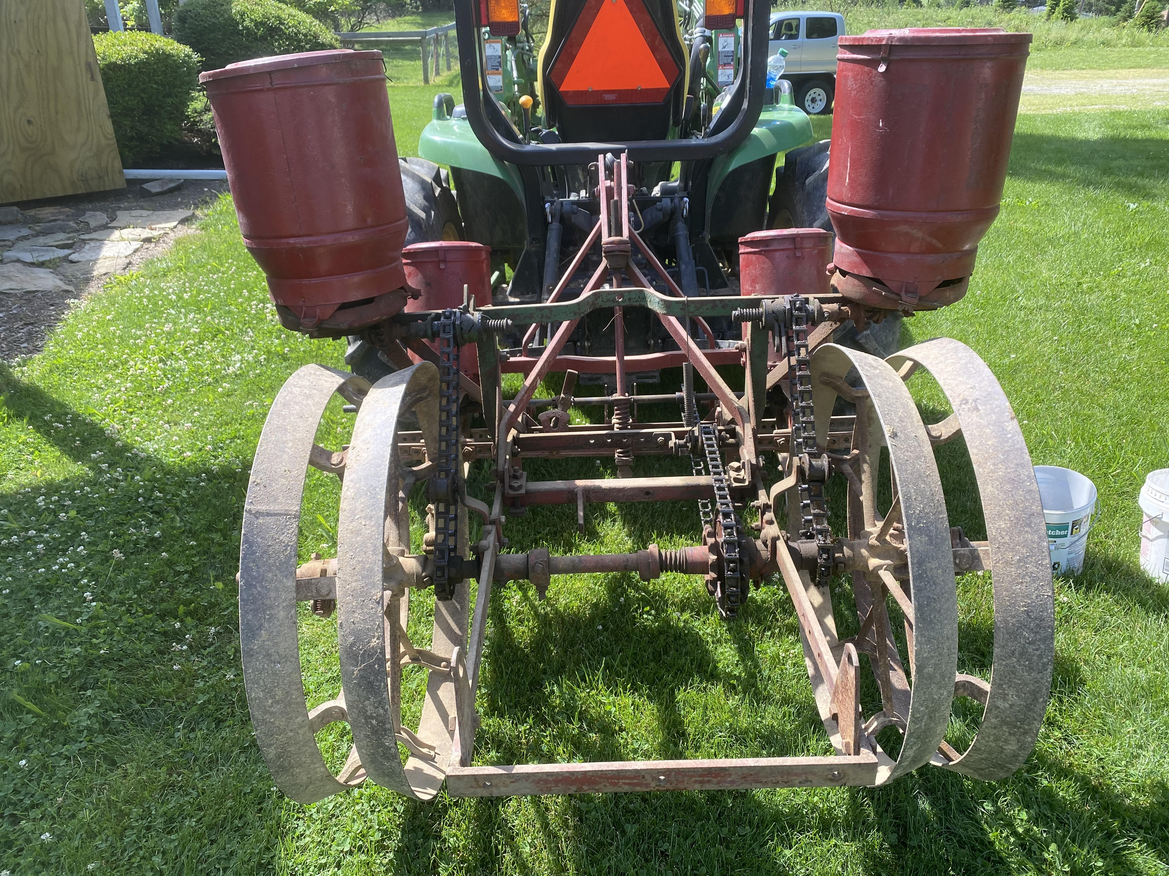

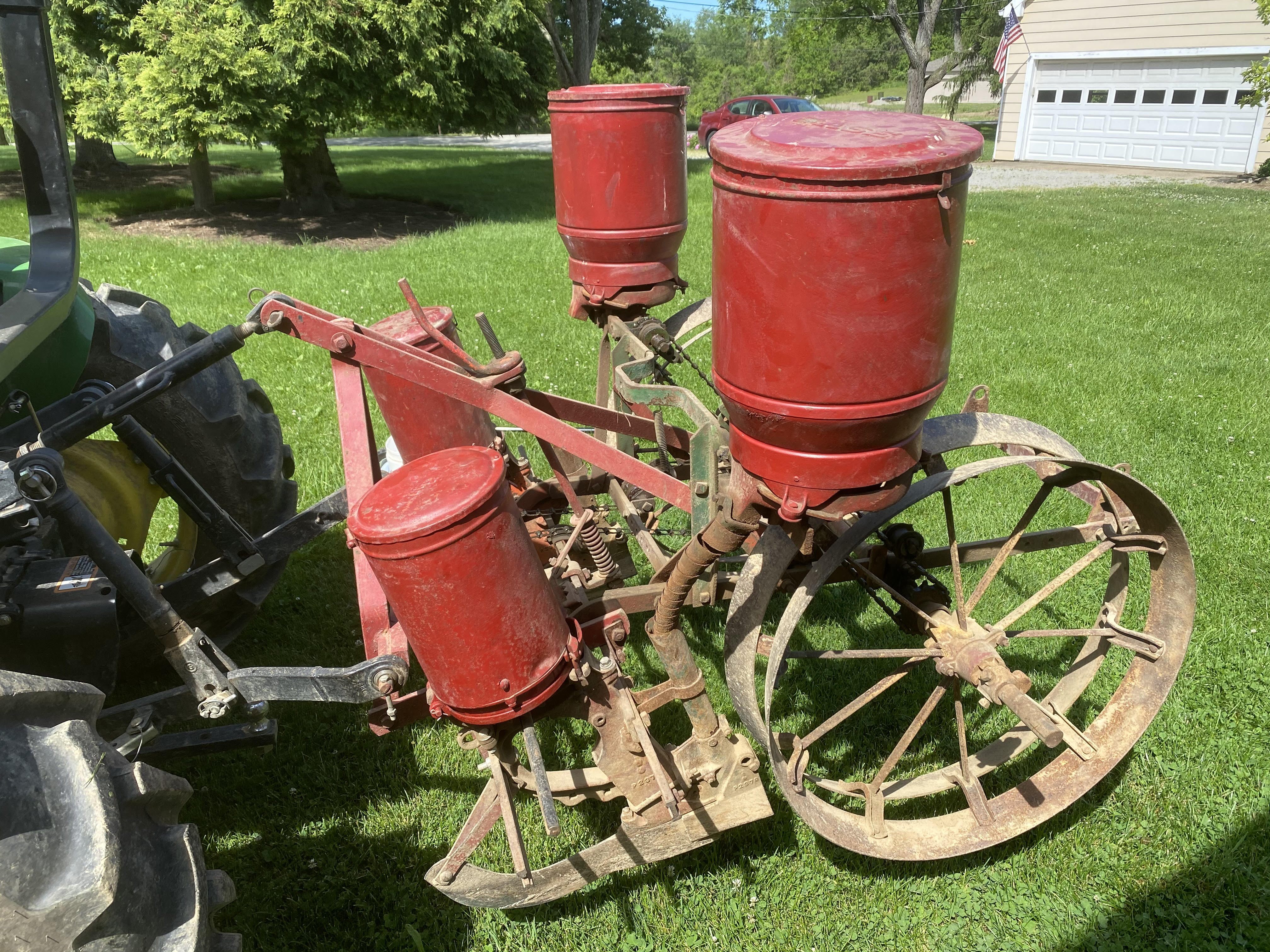

I bought this 2 row planter on Craigslist. The fine gentleman I purchased it from forgot to mention that only one row works - the other is missing the gear drive that turns the plate on the seed hooper. Grrrr.
So the first step in trying to find a part is to identify the specific model of planter. The top of the seed boxes and fertilizer hoppers says Case. However I can not seem to locate any Case planter that looks like this. Is it possible this is a Black Hawk or some other planter with the boxes added from a different Case planter?
Any ideas would be appreciated.

Any good machine shop can make that for you. You have the pattern from the working unit, just take that to a machinist to make a copy.
   / Is This a Case 2 Row Planter? I got ripped off on Craiglist #7
yep just what I was thinking. Already have a perfect pattern.
