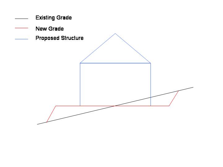

This is going to be built on a gental slope, so I will need a lot of fill to meet the grade.
Whenever I do any sort of grading work, I try to make the site balance. In other words make the cut yardage match the fill yardage... Unless you have a connection or a deal on the dirt, it can become expensive to import or export. Is there any reason not to cut into the hill and use the dirt to fill on the other half. As was previously stated, compaction is key when grading/placing structural fill.

I have approximately 35 to 50 tons of rock, gravel and topsoil. I have been clearing my land and Dug 9 trenches to pour footing for piers for a doublewide coming in. I think I have enough fill. I just hope trusses arent that expensive.
