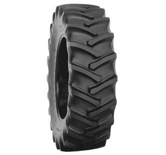

Like a loader type tire with more bite?
   / Is there such a thing as a tire in-between R1 and R4? #2
Some R4s are deeper and more aggressive than others.
   / Is there such a thing as a tire in-between R1 and R4? #3
Firestone has field and road tires. Kinda in between R1 and R4 and different angles of tread.
Here's what the field & road tire looks like.

Excellent. These are the key words (field and road/ hdap, 23* tread, 45* tread, barred turfs, etc.) that are helping me expand my search. Much appreciated everyone.
   / Is there such a thing as a tire in-between R1 and R4? #9
My neighbor has a B7510 Kubota with Barred Turfs. These were from Kubota, optional, and were a hybrid tire. He likes them a lot.
There are also HDAP which are a nice grippy tire but have no side wall strength to speak of. Grooving R4's might be a good enough solution. While there are a number of options, no single tire style will ever meet 100% of one's potential and varied uses. You just have to find the tire with least compromise for the largest percentage of your tasks and move on.
