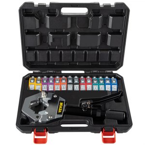

Would seem to start at about $100 and go up.... Try a "search" using the search string "hydraulic hose crimp tool"....
Then there is this.....
Would seem to me "affordable" is related to how many hoses you intend to make, obviously a more expensive, better quality becomes more affordable tool is in relationship to how well it lasts after a large series of crimps...

Keep in mind the one from Vevor is for AC lines that work at much less pressures than hydraulic systems.
