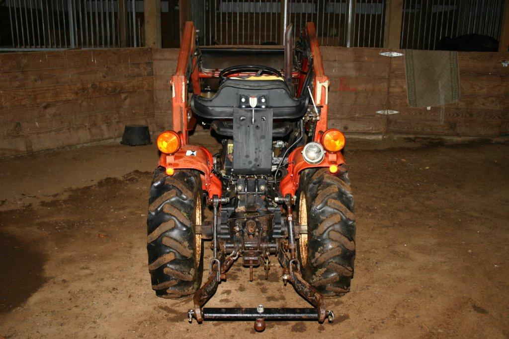

I expect YM186D is big enough to run a small frame mount backhoe. But my opinion is theoretical. Ductape actually ran one so his opinion should have far more weight.
What I'm curious about is if a fabricated mount would prevent normal implements on the tractor's original 3-point arms, and turn a general purpose tractor into a backhoe-only. Looking at Ductape's photos #YM186D-98 and #YM186d-163
and
, I see the mower rear mount replaced the tractor's normal 3-point arms and sway chains. Then the new BH subframe extends back into the area where an implement would normally attach. Ductape, could normal implements still be used?
For comparison see my photos of the standard YM186D 3-point:

The subframe on my tractor wouldn't just bolt to another 186D, unfortunately. I did use the brackets for my Woods belly mower to mount the subframe, and I also welded a new bracket that I made to the loader mount on each side. I made the back end of the subframe mate to what I already had on the backhoe, which was the mount Woods hade to attach it to a New Holland TZ25. That being said, nothing about that would be terribly difficult to duplicate by a decent do-it-yourselfer or fab shop.
As far as it interfering with the three point hitch, yes, mine did. But that is why I made it to be easily removable with six pins..... no tools required (unless I put the bolt through the draw bar mount). I could probably have left the three point hitch on the tractor when it was in use, but I removed it because it was so easily done by pulling six hitch pins. Most backhoe subframes today are made so that they can be left on the tractor without interfering with the TPH, and I would expect any decent fab shop to be able to make one the same way. Unfortunately for me, I simply do not own enough equipment to do that here. If you wanted to use the search function here on TBN, you will find several great threads on subframes made by other members. Subframes much nicer than mine.
