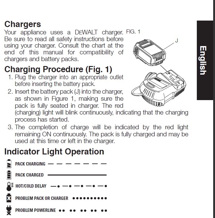

Just put the battery on the Dewalt charger and let it fully charge. It will also monitor and keep it charged and ready to go. The charger is going to be a lot smarter charging than you are. I have a few 20v that are 6 years old and still work as good as new ones.

My manual says you can leave them on the charger if you want. I just recently learned you have to push the battery on the charger until it clicks like when you put it in the tool. I had just been setting mine in the slot and sliding them down until the light came on. All of a sudden they started flashing the light a few times then it would go on solid like they were charged but they weren't. Then I found a You Tube video showing that you were supposed to snap them into the contacts on the charger. Problem solved.
