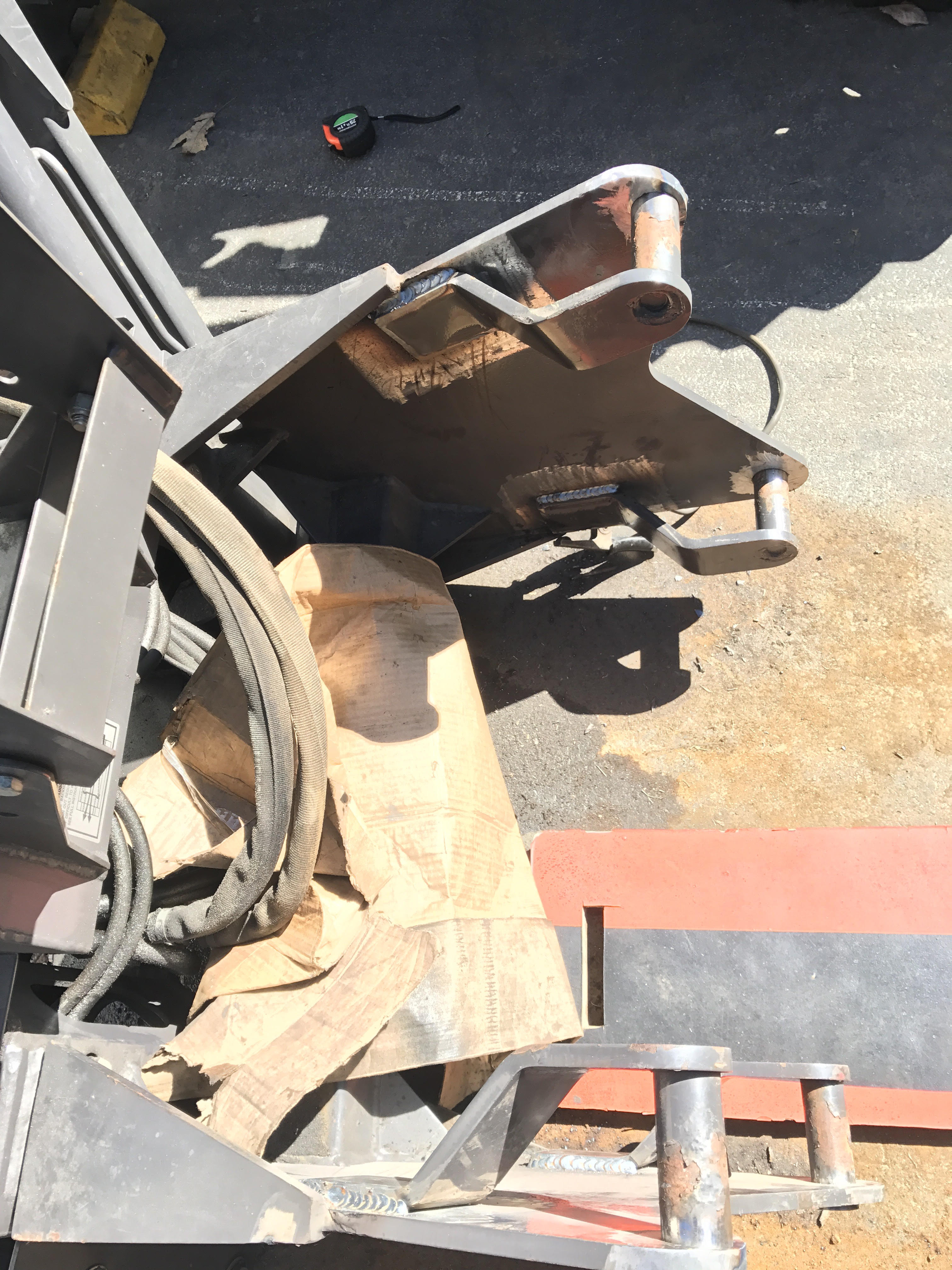

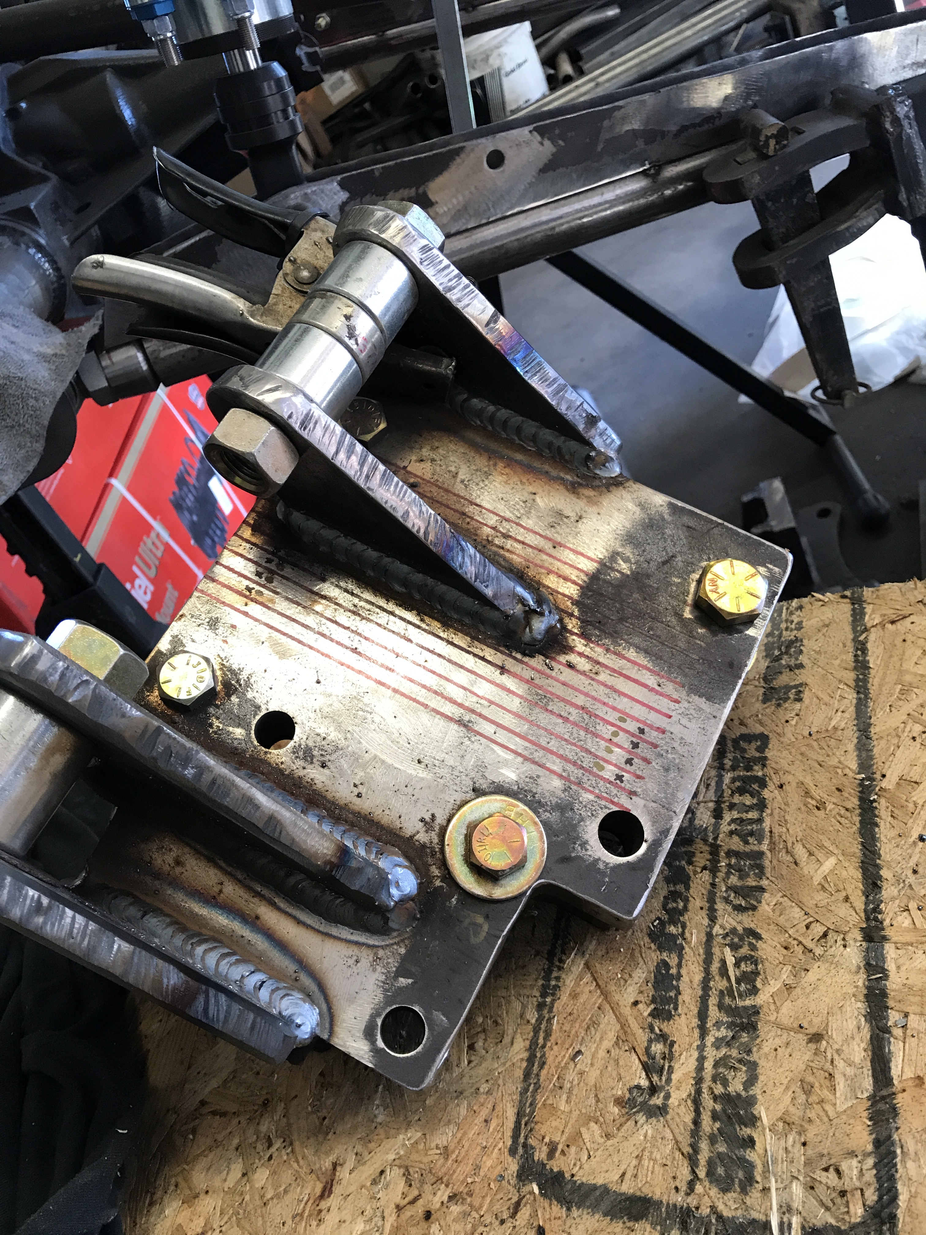

weld joint prep, beveling, pre-heat, smaller wire with better puddle control and slower travel speeds all allow better heat build up and penetration.
Here's 0.5" tabs, welded to 0.75" plate, with 0.75" plate bolted as backing and warp prevention, with no pre-heat.
0.625" brackets welded to 0.625" plate; no preheat
Neither at full output (7/10)
