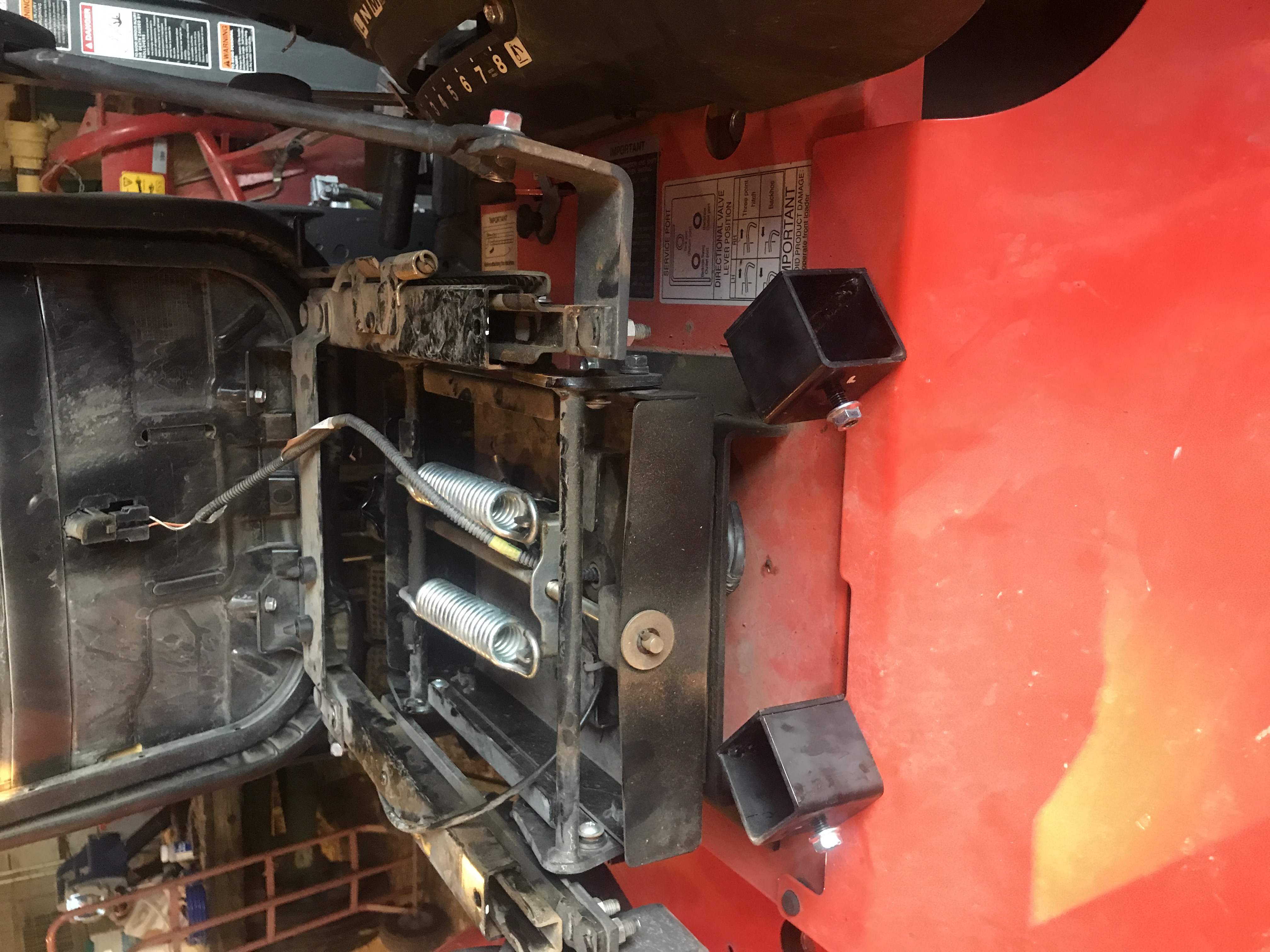

Yea, removed the 2 rubber bushings on both my m62 and m59 to combat that incline that makes you feel like you going to slide out. Plus, I did not realize the backs are adjustable. They have about 3 of adjustable recline and that helped a little by bringing the back forward. But I think it all comes down to the amount of travel in the suspension. I made some calls with not much luck but I am going to do some measuring and see if jd or case backhoe seats won't be too tall. Like was posted above all the aftermarket seat don't have the swivel.

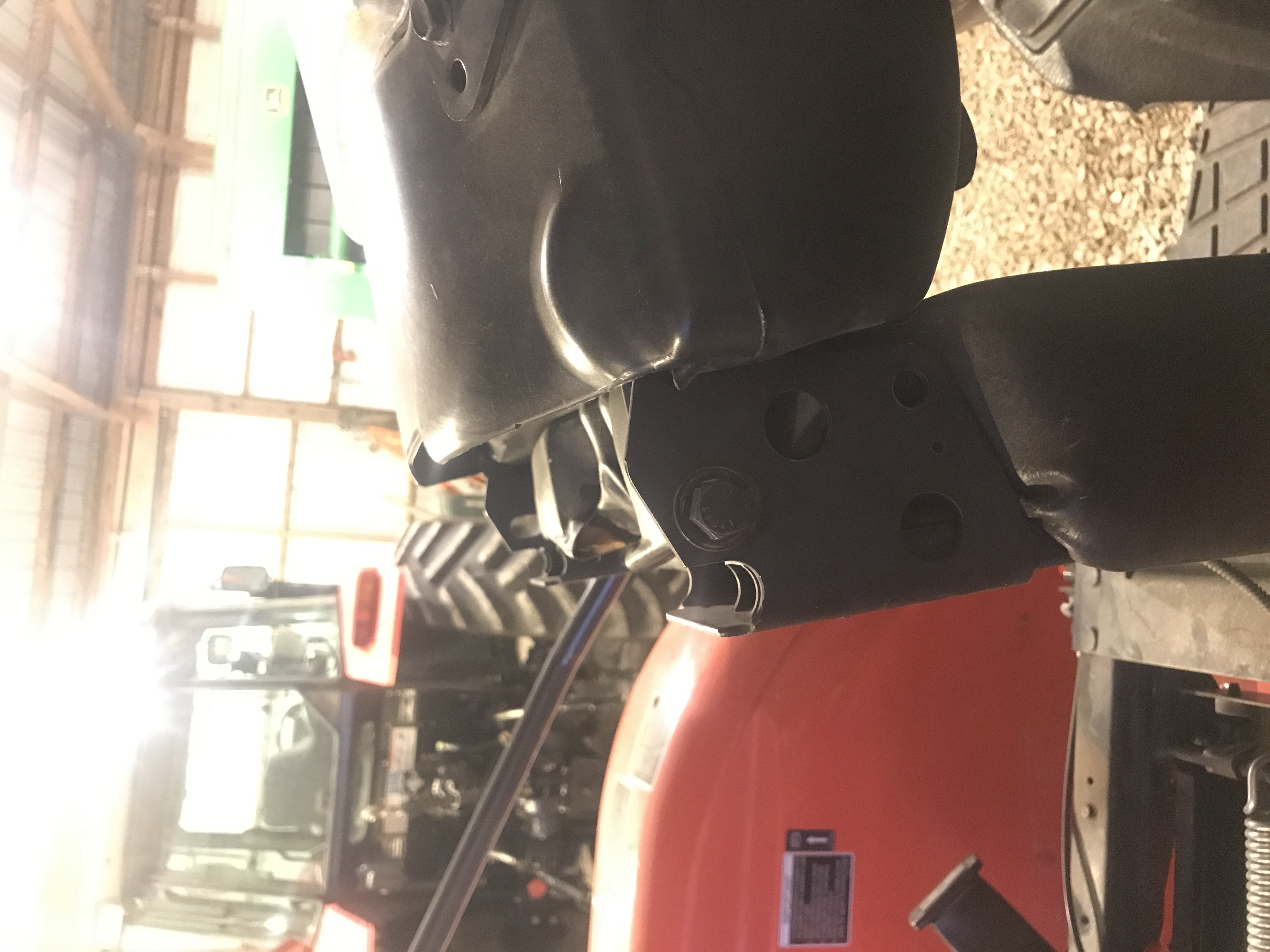

I removed the 2 square spacers and put rubber bushing back in .What a difference! It is angled so that you put weight on the back of your thighs. I adjusted the back all the way up and it sits great. I have to use it tomorrow all day so we will see. The pics are of the 2 spacers, and a pic of the bolt you loosen to adjust the back up and down just in case there is someone like me that owns a machine (m59) and does not realize there is adjustment. It is one bolt on the right side.
