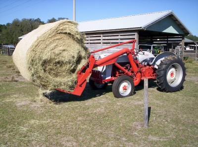

I think that machine will be ok for what you mention. though with 80 ac.. getting one larger.. say int he 50hp range.. you deffinately won't hurt.
if she don't move hay, just show her the following pics of my old fords from 1955 moving round bales on 1-arm loaders... that should shame your tc40 into moving the hay.. ;)
