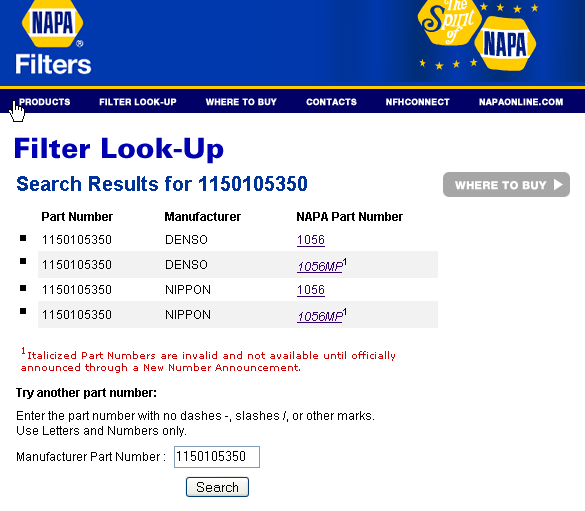

That did it! their wed site crossed the filter no. but that was the only web site that did. none of the sites listed that filter, and none of the sites show the 3215 in the model list. I'm wondering which Mitsu it is.
Thanks for your help.
Mahindra Oil Filter no. 115010-5350 is a Denso, and crosses to Napa 21348
Mahindra Hydraulic filter no. 19642509000 is IHC, and crosses to Napa 7118

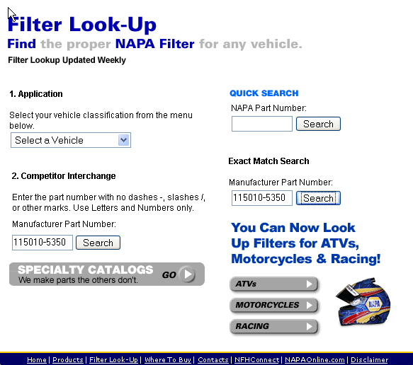

   / Is the Mahindra 3215 a Mitsu. I need filters! #8
I checked NAPA web site (NAPA Filters : Filter Look-Up) and I came up with a cross reference number of 1056 for the Denson 115010-5350. The other filter number matched.
