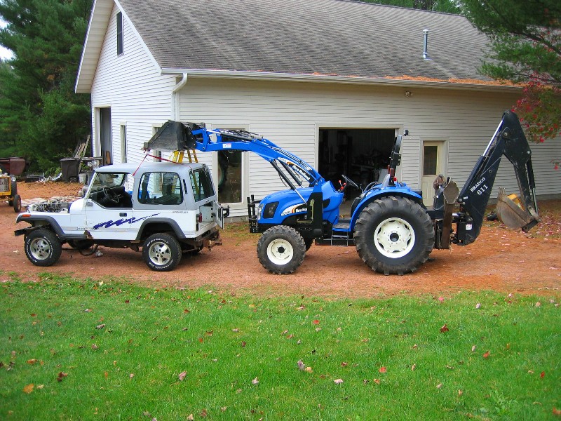

The bradco 611 backhoe on my TC 55 is quite heavy. I left it on as it provided tremendous traction advantages on snow and ice. I didn't even attach the front weights as everything seemed to work out fine. I have a 300' winding steep grade drive. My final passes are done going down the hill. Ultimately its your decision. Good luck.
* I'm a believer in counterweights.
