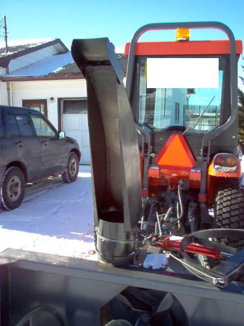

In wet snow blower chute clogs up to the point were it is unusable. I have about 35 residential driveways to clear and using FEL is a pain. Looking at other even smaller tractor/blower that were able to blow the snow, not very far, but not clog up. Chute too tall?, square shape a problem?, "hole" too small? Any suggestions, modifications ... that migh help. Pic show blower chute.

If the snow is wet/heavy, the height of your chute will be an issue. There's alot of area there for it to bind before it clears the top.
If they offer an option to replace with a shorter chute, I would do it.
   / Is something wrong with my snowblower? #7
Most blowers now would not have that 'stove pipe' tube in there - the round part. That does look a little tall. It also appears to squeeze in just a bit to the top???? That would cause the plug, unless it's just an optical dilusion.
I see they wrap the turn cable around there, but if that 6"+ section were only a 1" swivel collar that would help I believe. The rest of the tube is square & open, so should not be a problem. Perhaps it slows the snow some, and that backfeeds into the round part..... But I look at the round tube as the bottleneck.

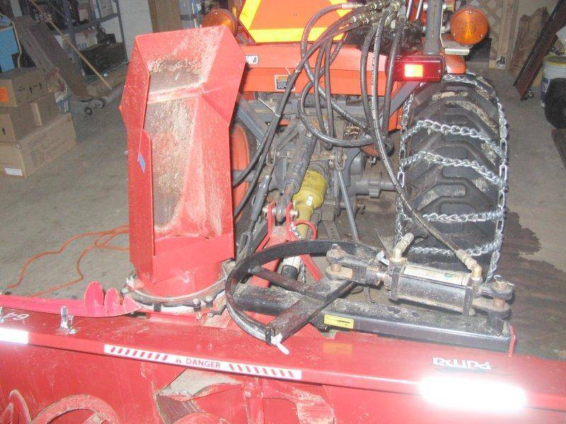

Those JRW blowers have extra long chutes. It looks like my Puma has a chute that is about 1/2 the length of yours. That could well be your problem since mine works fine in heavy wet snow, even when mixed with some dirt. /forums/images/graemlins/blush.gif
