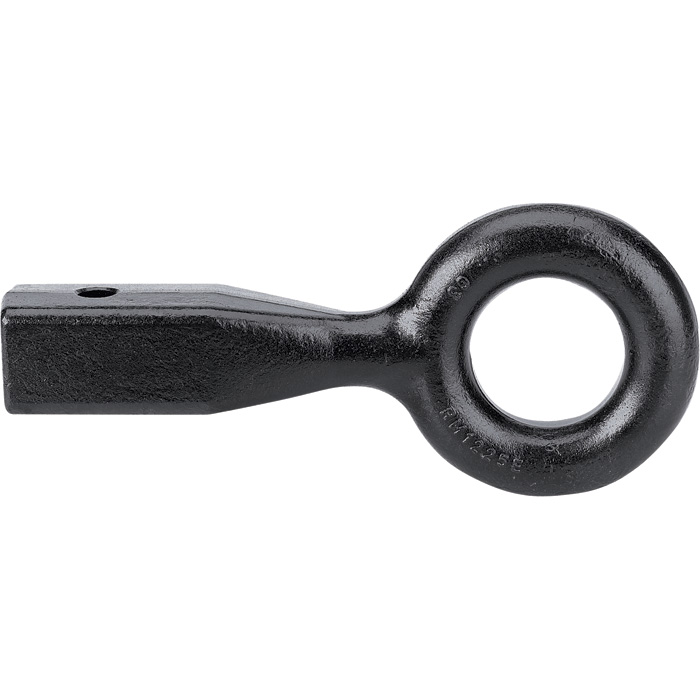

When I purchased our PT425 I also purchased an extra quick attach plate. I welded a 2" hitch receiver onto that. I suggest you do the same. It has proven to be very handy. I put in a ball hitch for moving trailers around. And I put in a 3" towing ring for moving logs. I run the chain through it and it works very well.
