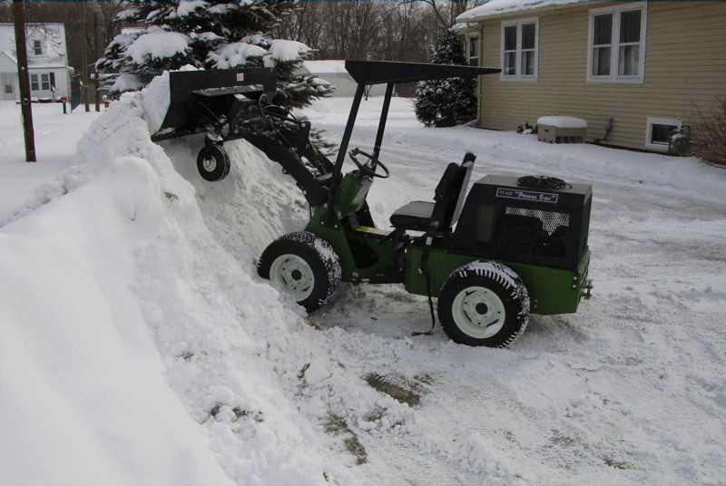

6" of snow is not much for the PT to handle. I have the 60" snow blade. It works great on our paved drive. Don't know about gravel, though. Our driveway looks to be a normal width drive, so it takes 3 passes total. With your drive being almost half a mile, you are looking at a 2 mile trip with 4 passes; down, back, down, back. At 4MPH it is going to take you 1/2 an hour. 6MPH will take 20 minutes. I plow at full speed(8MPH) on the pavement and it never has troubles. If you could maintain that speed, you'd be done in 15 minutes. While a pickup truck would do it faster, just how much faster do you need to go? /forums/images/graemlins/grin.gif And will a pickup do the other jobs you need to do? Also, the plow is pretty reasonably priced, in my opinion.
As for the tires, I use turfs. I believe they provide superior traction on pavement due to the fact that there is more rubber on the ground. Since you are following the plow, the pavement is always clean. On gravel, I would imagine bar tires would be superior. No science to back this up, of course, just my opinion so take it with a grain of salt. /forums/images/graemlins/smirk.gif
Also, can a pickup plow do this? (see attached). That's about 6' high. /forums/images/graemlins/grin.gif
