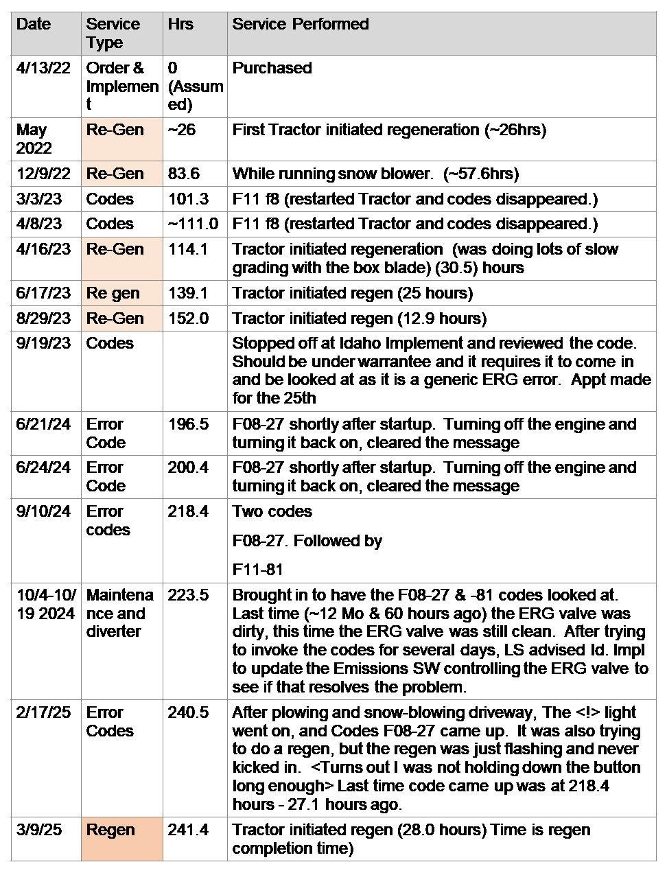

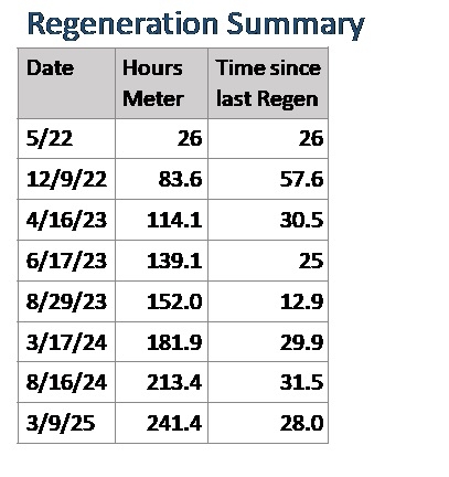

I have had some mildly irritating issues with emissions systems on my tractor. It is the LS MT235 HS.
Seems to be related to the ERG. I took my service log and tried to keep only the items related to emissions. I also have a regen summary as I track that. I may have deleted a few of the regen lines off of my service log by accident so they are not in synch.
I have not used the tractor much this summer so I am not sure if the codes that popped up in Feb were related to me deferring the regen, or a recurrence of the issue since they updated the Emissions SW or not.
My Service Log
