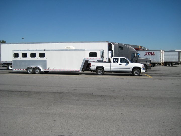

   / Is it worth it to have a slide out installed on a horse trailer?
What the horse trailer looks like. That was our old truck we used, don't worry, it was a 2500hd and pulled the trailer just fine.
