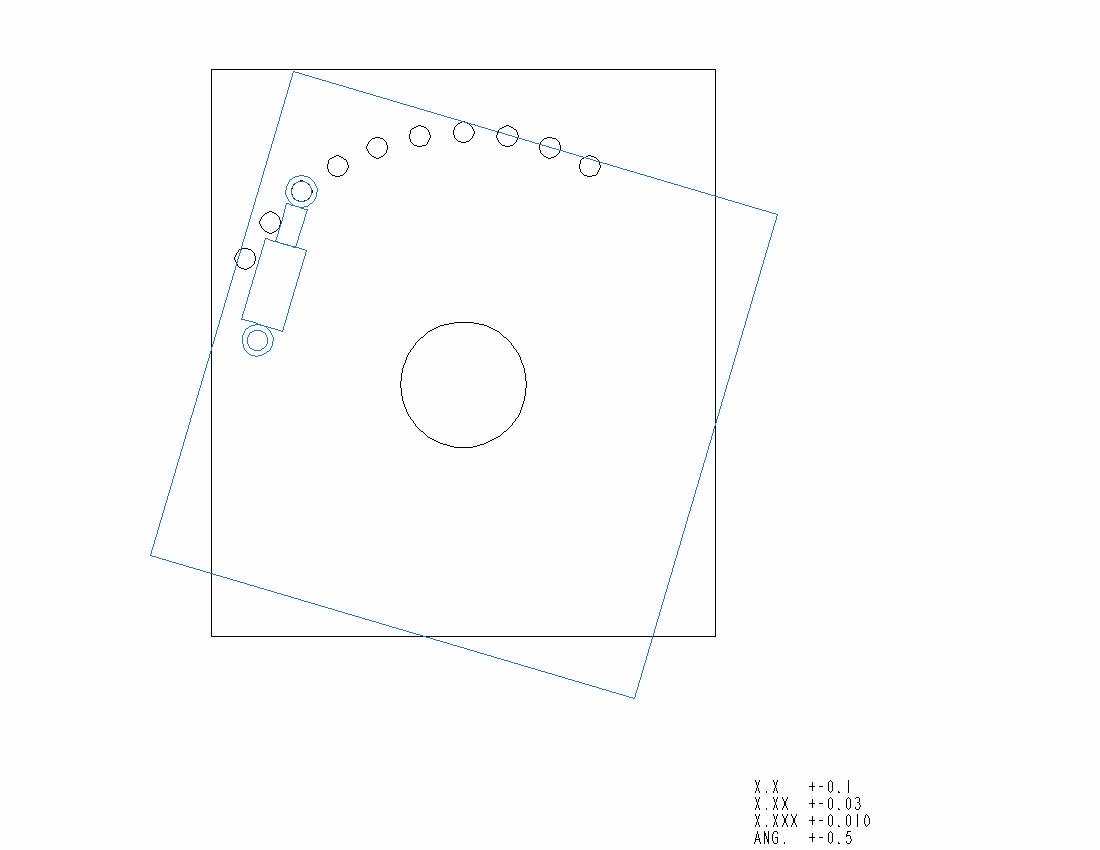

One possibility that I considered is to use the stub, bearing and flange from an old trailer axle, welded to a quick attach plate, with a replica of the male quick attach in front. It would extend forward, of course, and would have significant leverage and thus load on the attach plate, and would require a clever device - hydraulic or mechanical, to control the roll. That would allow adjustment of any attachment. It'd probably break with the load of serious grading, but maybe not. It's on the list, and I have the axles, but its another that I may never get to.
   / Is it possible to swail with a 400?? #7
<font color=red>One possibility that I considered is to use the stub, bearing and flange from an old trailer axle, welded to a quick attach plate, with a replica of the male quick attach in front. </font color=red>
Charlie, see attached for a simple way to rotate your contraption. The holes in the female plate (black) are for course adjustment. A Hyd. cylinder or turnbuckle attachet to the male plate (blue) could be used for a fine adjustment

I should mention that I'm happy to lay the hole patterns etc. out on my CAD software if it'll help you guys out. Just give me the dimensions of the quick attach plates.
   / Is it possible to swail with a 400?? #10
Charlie,
<font color=blue>It would extend forward, of course, and would have significant leverage and thus load on the attach plate</font color=blue>
I've been thinking about this some more. Since it is not constantly rotating or rotating at a high speed, you could get away with a pipe inside a bigger pipe with a grease fitting. This may make the contraption more compact & reduce the load problems. Also if you used big diameter pipes, you need not worry about the bending moment.
I don't know how thick the quick attach plates are, but you should be able to squeeze a small hydraulic cylinder in a 3" gap. Might take some carefull engineering & some access holes in the plates to get everything bolted together. A turnbuckle might require more space as you need to get a wrench in there to rotate the thing.
