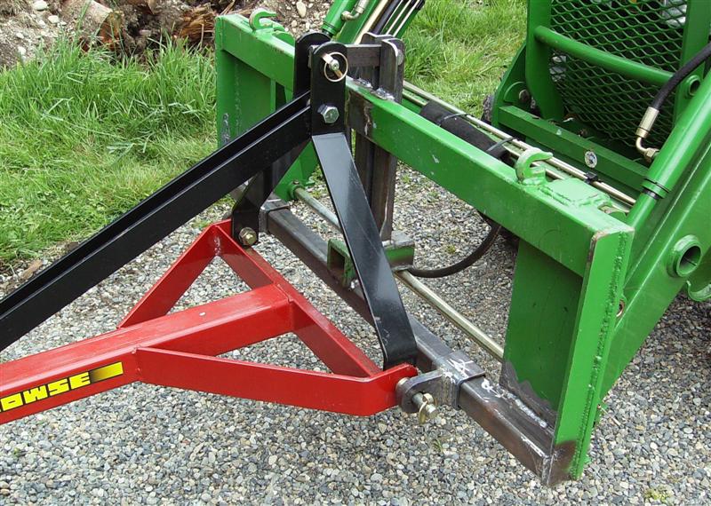

I've added a piece of pipe to my back blade for use as a snow removal blade. It fits over the cutting edge and does a great job of floating over the stone in my driveway. However, since it's a back blade, the tractor has to drive over the un-plowed snow while the blade drags behind. It does work but it would be a lot nicer to have the rig mounted on the front like a typical plow.
So I'm wondering if it might be possible to fabricate something that would allow me to mount the iMatch quick attachment frame with the rest of the back blade on the front of my 4120 via the FEL arms. Kind of a poor man's plow. Anyone done anything like that? Any reasons I might be overlooking that would prevent it from working?

Should just have to have the top hooks that are on your bucket now, fabricated to weld onto the iMatch as well as the stubs at the bottom. May need to add some width to the iMatch. Or make a plate that has the 3 ph attaching points to transition between the FEL and the iMatch.
That said, the back blade doesn't have trip and release protection, so you may have some abrupt stops or failure of parts when mounted to the FEL. That could make you poorer in a hurry. Your pipe addition may prevent that.
Check out previous posts, as there are several who have mounted snow plows to their FEL and like the arrangement. I mounted a 7' plow directly to the front frame on my 4300.

While back I converted my front 2" receiver hitch thiny to except 3pt stuff.

I'm of a similar mind with beenthere. The overall length of the rear blade and iMatch hitch hanging off the loader arms - huge lever - and just the force of the blade coming into a berm or the edge of the road... well, I could easily imagine that the loader arms could suffer significant damage!

Hmm. You could be right about the balance and awkward weight distribution. As it is now, the blade hangs off the back of the tractor by quite a distance, enough to allow the blade to swing 360 degrees. That would put a lot of stress on the arms especially if one edge got caught. Maybe I'll skip this idea and if I get really sick of driving over the snow with the blade on the back, start saving my pennies for a real plow. My driveway is simply too long to navigate going in reverse. My neck would be in a permanent spasm after one storm!
