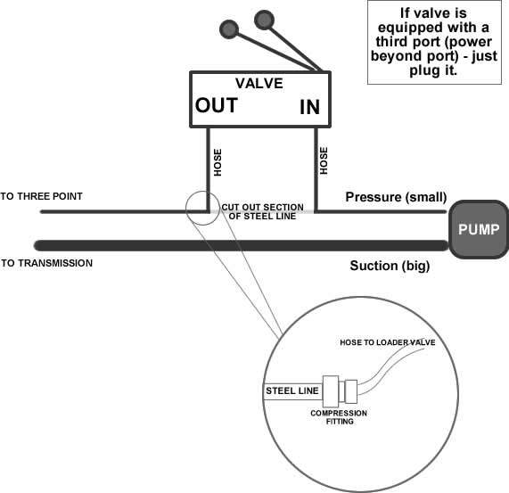

Maybe this will explain it more.
My tractor's pump (for the three point lift) is producing 2000psi and about 3.5gpm.
I want to add a loader and power steering.
I was going to add the loader like shown in the picture below.
The power steering has me stumped though. Almost all the power steering valves that are available in the used market are rated for 1500psi or less. Even the ones for cars and forklifts.

Thanks JJ. So how would you intall a loader and power steering on my machine.
I really am not a hydraulic expert...as you can tell ( I am just a Baptist pastor who loves to get his hands greasy now and then.)
Would you hook the loader up as pictured and then a Priority Diverter Valve after that for the steering? I would prefer that the relief for the loader and rear hitch lift be more toward the 2000psi range.

Your main pump would go through the divider valve, the priority flow would go to the steering, and has adjustable relief. This one comes set to 1500 psi, but can be adjusted. The fluid not used by the PS, would go to the loader valve. If you have a 2 GPM priority for steering, and your supply is 10 GPM's. then 8 GPM will go to the loader. The loader should have it's own relief valve.
The priority valves are selected by the GPM's that you want the steering cyl to operate.
There are plenty of PS kits on the market.

I would absolut recommend/make sure there is a main pressure relief valve ,protecting pump, before flow hits the flow divider.
Rule of thumb and OSHA??, first valve after a fixed displacement pump must be the main pressure relief valve.
And using the main tractor pump, I suppose this setup will be "powered beyond" the 3p assembly, so that should take care of the main PRV ...
