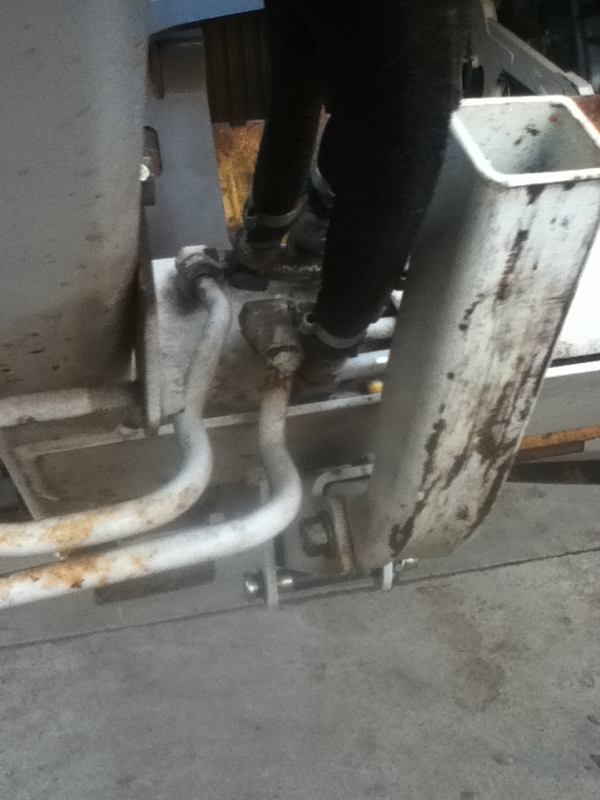

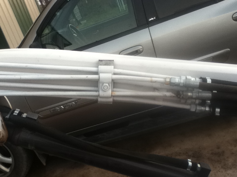

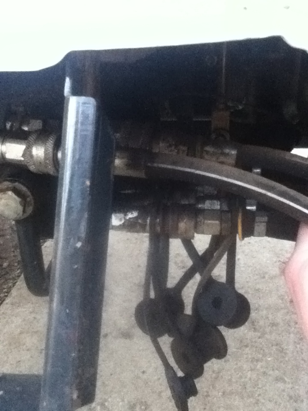

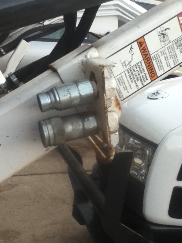

May not be a Deere but I made my own hardline kit for my Bobcat CT235, i made all my steel lines with hoses, very simple. I just put a T off the hose where it comes out of the valve with a ball valve and leaves the rear outlets free, and if I have a grapple on front and hydraulic attachment on back I turn the valve to shut the front off and use the back.

Its relatively easy. I've done it on my 3320 (open) and 4720 cab. Just take your time, study the parts- the only thing that is close to being tricky is fitting the tubing sections on the front loader arm-they kind of "nestle" into the right spot. You could probably save a few bucks and just buy hydraulic hose made up to the right lengths with two pairs of quick connects but the 300 bucks for the kit insures you have all the right stuff.
