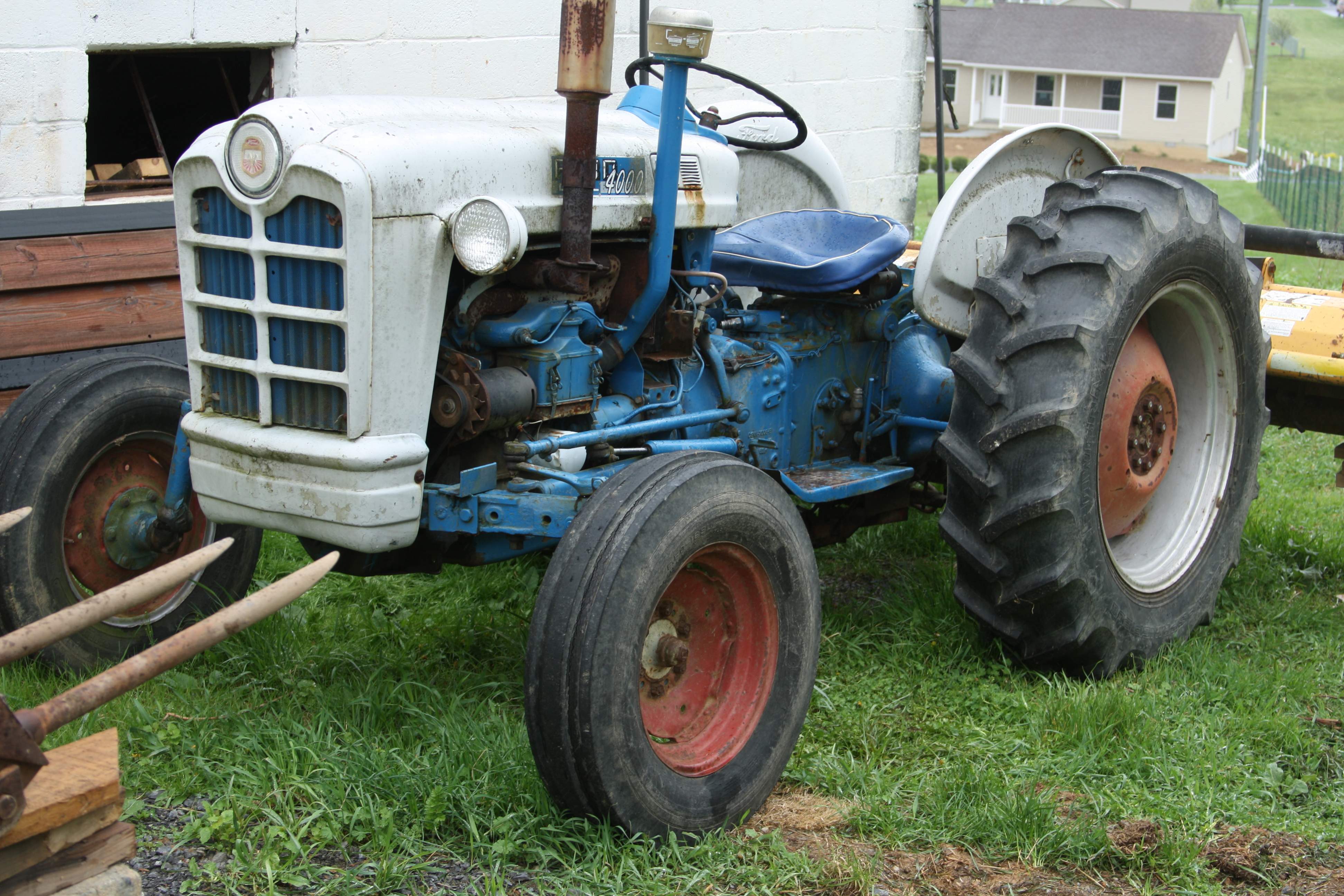

After reading the threads on select-o-speed transmissions and doing my homework (I thought) and driving the tractor until hot, I decided to take a chance and buy this old tractor that was advertised as a Ford 4000. My rational is to use the Ford as a mowing machine and leave the backhoe on my other tractor (Kioti LK3045xs). The tractor runs well and has the features I want, an independent PTO, live hydraulics, power steering and a 4 cyl. diesel with lots of power. As I have been studying this tractor I have started puzzling over the 4000 designation on the hood. The grill and medallion style appear to be that of a 800 series tractor, specifically a 871. The serial number is missing and may have been grind smooth and under the blue paint is red paint (finish color or primer??). The transmission housing just above the inching pedal has the raised marking C3NN-7006-B next line B CWC . T . next line .1165. One thread mentioned that if this marking starts with a C it is a later model SOS transmission, which originally gave me some of the confidence to buy it. When in a gear it does not free wheel going down hill so I am assuming it is a direct drive clutch SOS. I値l be trying to make the best of this rig and would like to buy some manuals so I can start with some filter replacements and a tune up. But which manual to buy? I suppose it could be an 800 series tractor with a newer transmission perhaps from a 4000. Any ideas??

I think there were some rear axle improvements on the 4000 over the 800. I had the four cylinder 4000, with, the SOS, that had the tin work of 800 series. It was a pretty good tractor for tilling as the 1st gear was Looww. It smoked black a little. It probably could have used a pump and injector rebuild but in my area it was cost prohibitive. I was told it might be designated as a 871 also. It had 11-24 rear tires and was a Low Center of Gravity tractor. bjr

The sheet metal is definitely not a 4000. There was no emblem on the front top of the cowl like the Jubilee had. All it had was a chrome cap on the hood that retained the curve from the days of the emblem and they just added a little grille and kept the hood. On the rest of it, who knows. Old tractors could be made from many previous units.

As others have mentioned, in the last 50-60 years, who knows how many swaps have been done.
Really, the only difference between an 801-series and a 4000 was the sheetmetal/grill and paint.
Yours clearly has sheetmetal of a 801. And the re- paint under that blue is also another clue that it was an 801.
It appears though that the transmission doesnt have that red paint under it.
So, here is what I suspect.....Someone put a 4000 transmission in there, ground off the serial # (who knows why). And then at one point, it was re-painted as a 4000 and a 4000 sticker put on. (which doesnt makes sense why they would grind off the "4000" serial # if there intent was to make it a 4000):confused2:
Of course that could be totally wrong though. Maybe they had a 4000 and over the years, replaced everything with 801 parts Except the transmission:confused2:

Given the engine # AND the sheetmetal....I'd say you do indeed have an 801 and NOT a 4000
Though the transmission appears to not be original what make me or you think it is from a 4000? Could it not be a newer version tranny still from the 801 series?
It "could" be a newer 801 series transission, but as you said...it appears to NOT be original. I am basing my "4000 transmission" theory on only two things. 1st...you said the guy who sold it said 1165 meant NOV 1965. That may be true, or it may be BS, I dont know for sure.
But also... there appears to be NO red paint under the blue on the transmission. There really werent any differences between the 801 and early 4000. Just minor sheetmetal changes, and the color. The 801's were red, the 4000's went to blue. So IF all you your tractor has red paint under the blue EXCEPT the transmission....well I think that answers it.
