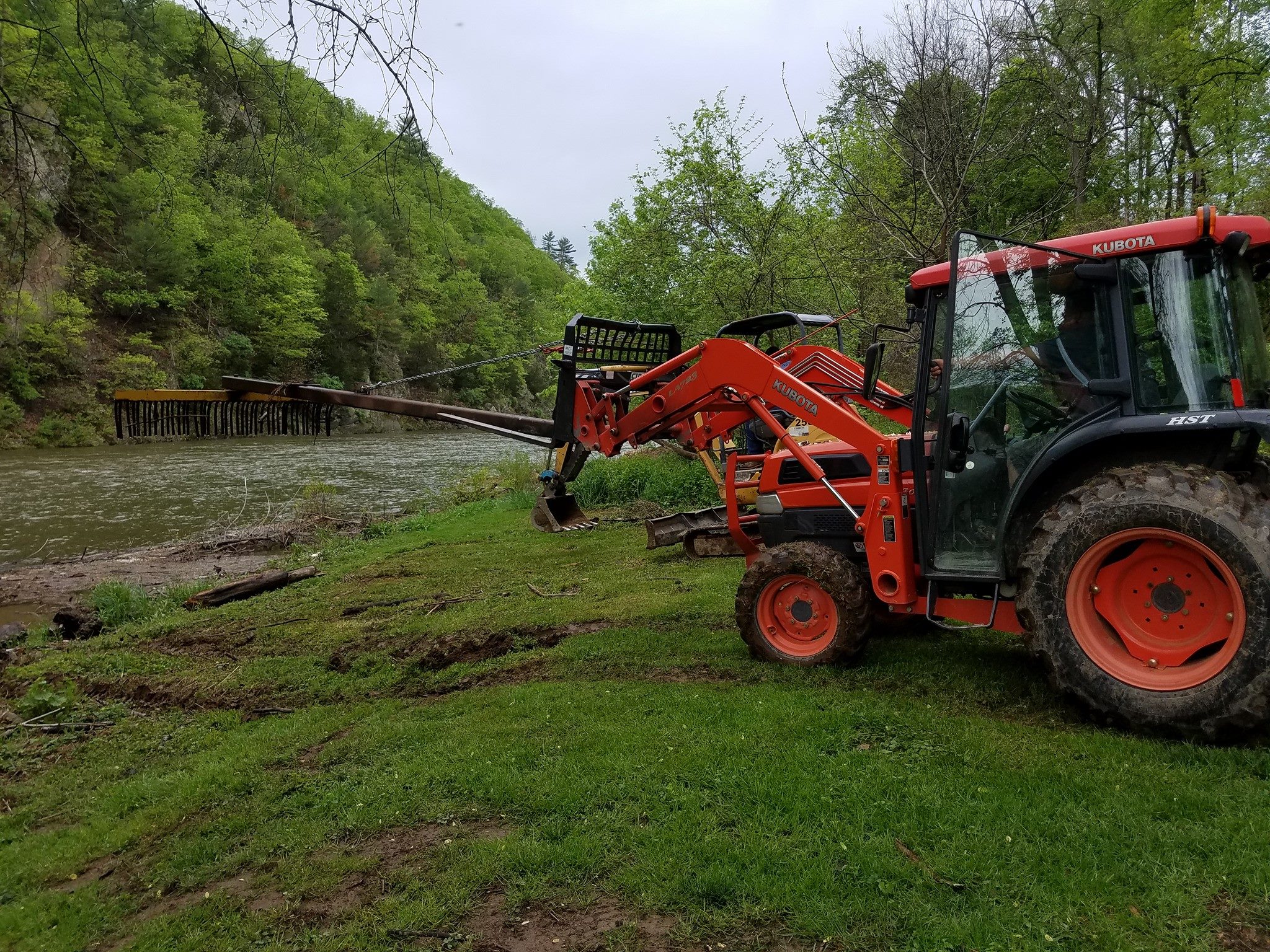

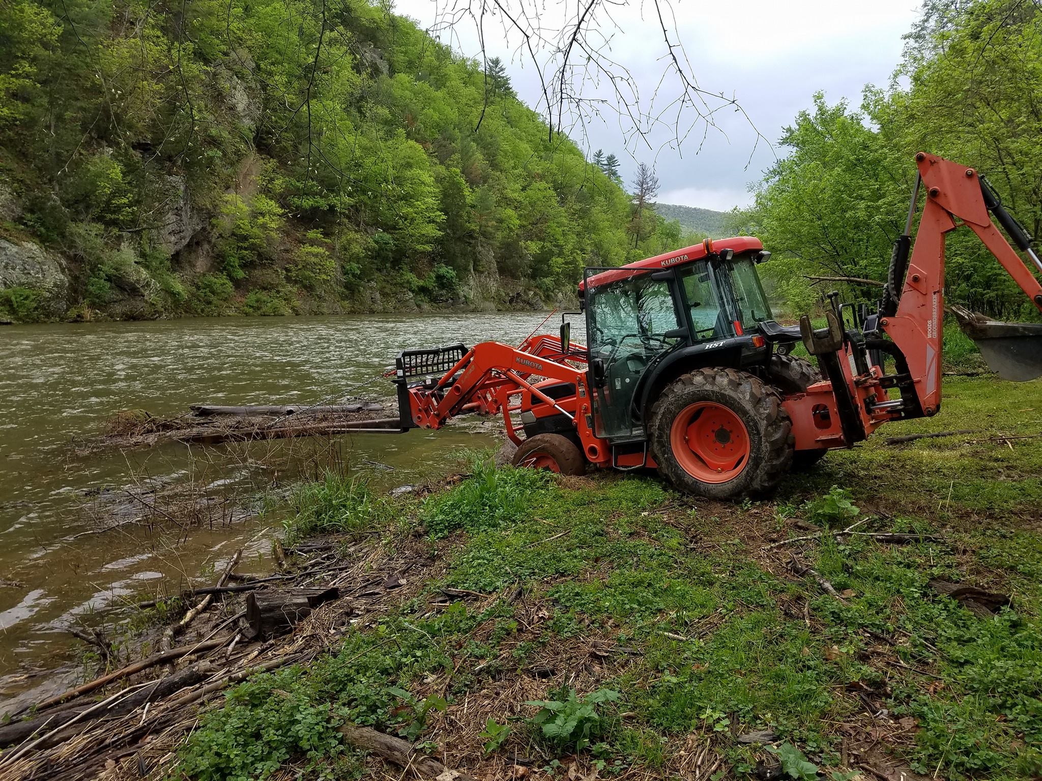

The picture was our pathetic attempt to build a boom and push debris back into the river. It's a long steel 6x6 with 3pt rake on it (3pt part was removed)
You can see tractor was pulled out by a mini-ex, which we were lucky to have nearby.
