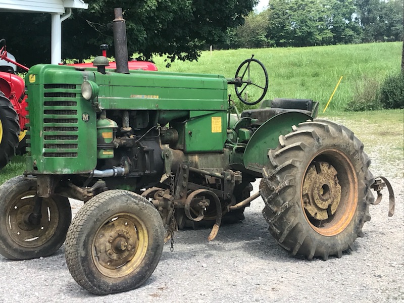

We have 2 John Deere Model M's One, my Dad bought in 1967 from his sister in laws father, who bought it new in 1951.
I plowed tobacco with it from the time I was 12 till I turned 20, when he stopped raising tobacco crops. We still work the garden with it.
Its still a fine little tractor for the garden, and odd jobs around the farm. We also take it to tractor shows from time to time. It has the cultivators, the plow, and the mowing machine still with it, along with the draw bar attachment.

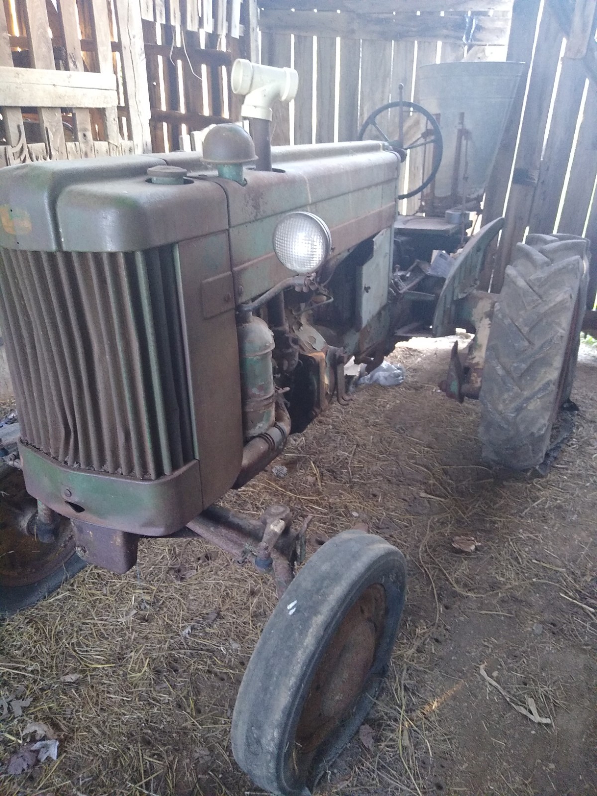

The other one belonged to my Dads older brother, and I ended up buying it, i guess around 3 years ago. It has not ran since before
my Uncle passed away in 1994, and is a project tractor. It's one of those things I will get to eventually. It came with the cultivators, draw bar attachment, and a seed sower. It did have a tobacco setter, that they mounted on it every year when I was a kid, but I think they scrapped it years ago, before I got a chance to buy the tractor. It does have an MC or a 40 grill on it that the original was replaced with years ago, when he ran over something and messed up the original front grill.
Picture of Dads M
Picture of my Uncle's M
