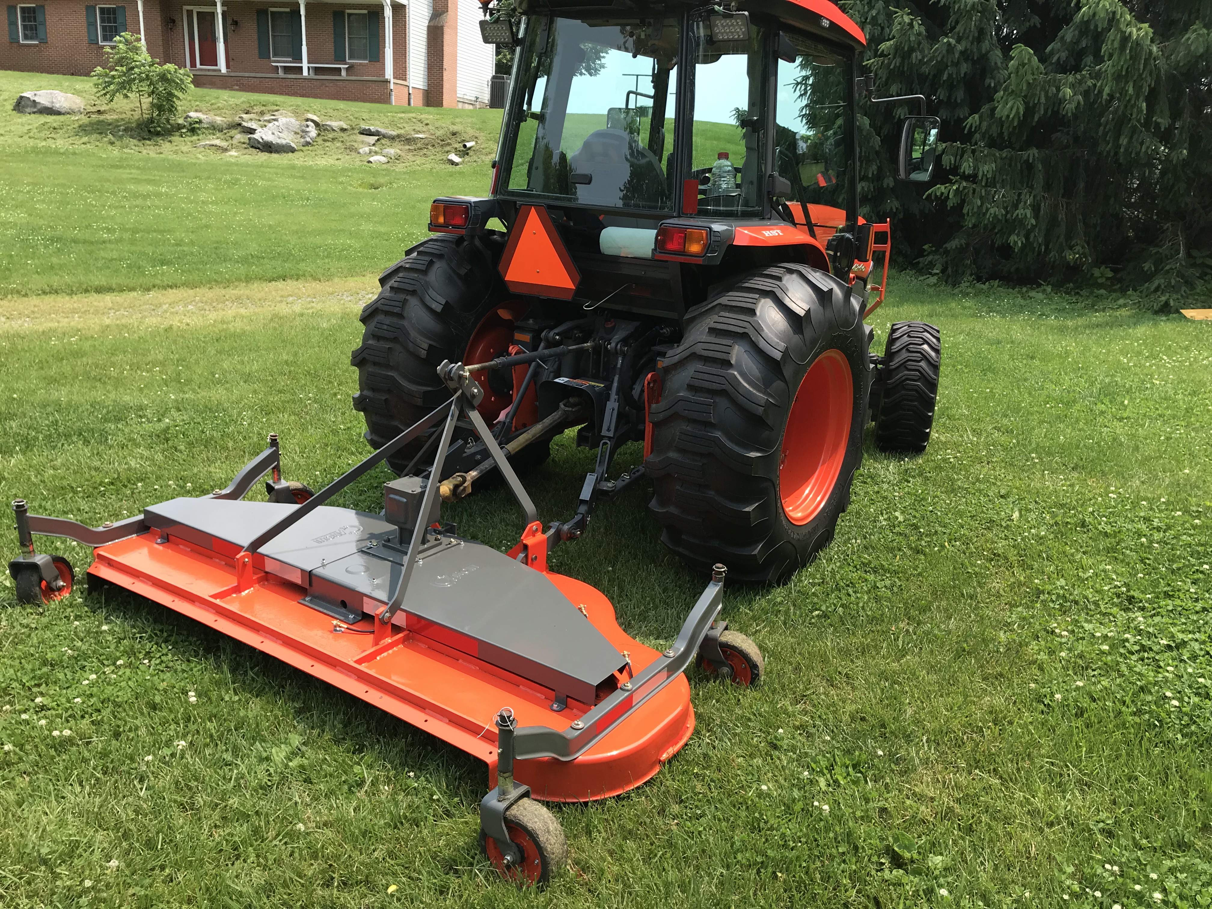

We have 3-1/2 acres with trees, creek, sheds, house, etc and the L4240HSTC with loaded R4's and a 7-1/2' Caroni RFM is the lawn mower. It cuts close enough to everything so there's no need for a walk-behind mower for trimming. Whatever the Kubota doesn't reach can be done with one 20V battery in the DeWalt string trimmer.
