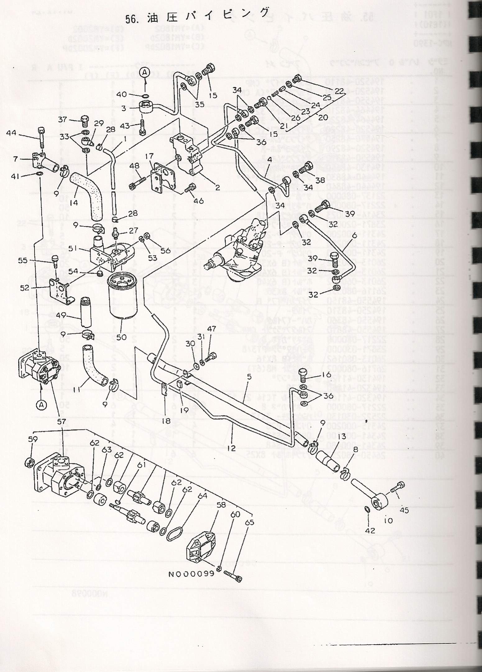

So far I've only seen a few photos but the tractor looks very well cared for and, according to the farmer, it runs great and he hasn't had any problems with it. It also has power steering but I wasn't sure if that was normal or an option on these. Is there a way to tell if it's an add-on?.

The power steering is likely an add-on, it is not in the parts manual for a 1602d. There was power steering available for similar models made for he North American market, or there are multiple vendors that sell after market power steering kits. I am in the process of adding power steering to my 1602d and i would really appreciate any pictures of the setup if possible.

I think you will find that is factory power steering similiar to the 2002 and 1802. Here is a parts drawing of their set up.
