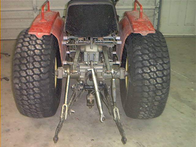

Normm that's why I replaced the rice tires with Goodyear Terra Track 16X13.5X15.5 tires sure makes a big difference in tearing up the yard.
Bob

What did you use for wheels? Is the rolling circumference the same as the rice tires so it can be used w/ 4wd?

Ozarker:
Check Bama's profile and he's got a link on there with pic's and story on the turf's
Rolling circumference dosen't matter if it's not 4x4 and from the pic's I don't think it is.
