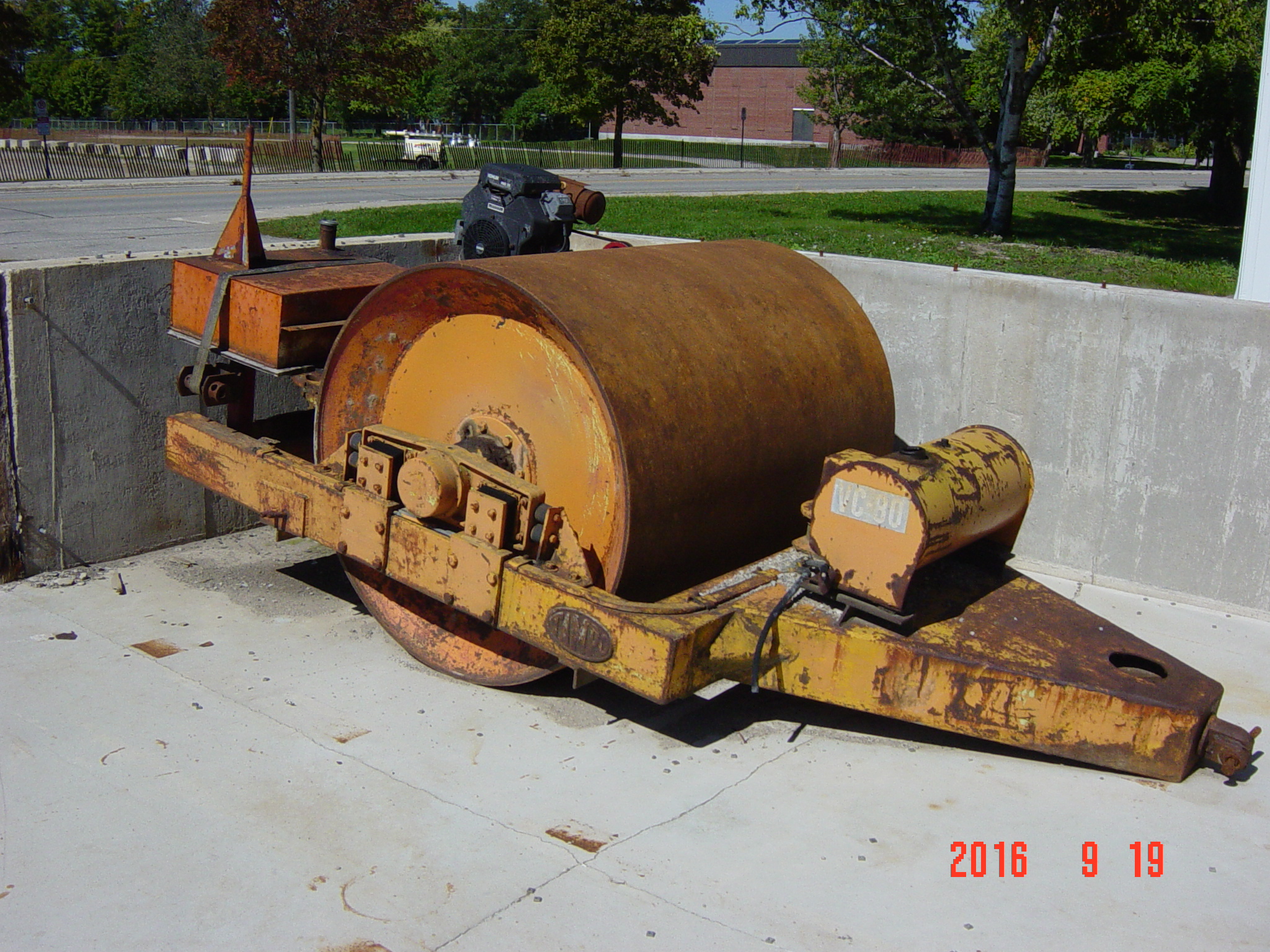

I tried to buy this one a little while ago. Made an offer and never heard anything back. Another thing, that no one else on my block would have had.
I tried to get one like that as well, but none in the area, and ones I did find were much to big. I'm looking at building one with a section of pipe, plate to close the ends, rod for an axle, and oak bearings. The pad feet can be short sections of pipe (2-3 inches) long cut in half to make 2 semi circular pieces welded to the drum.
