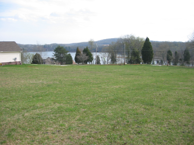

I too cut about 2.5 acres of field grass in a recently developed area (for future homes). It's a typical field that has bumps and semi-rough terrain. I use a 60" MMM to cut it down about every other week. Works very well for my needs. I'd think you'll be good with a 60", unless you feel that you want to cover more ground in less time with a 72". I went with a 60" to allow a bit more versatility in the (lesser) width, for use on other areas that I mow. The machine itself will cut the grass quite nicely, especially after you cut it down a few times. I run my machine (B7800) around 2200 RPM and it never struggles. I have noticed that it doesn't like damp grass very well, but none-the-less, it works fine.

Looking at your photo, my field grass is a lot less civilized looking (much more bunchy and tufted). However, it's still sounding good for the use of a MMM. In terms of size, I like the idea of covering more ground per pass with the 72" version, however, something tells me to not overdo it and stick with a 60" (and most of my other implements are 60" versions as well).
