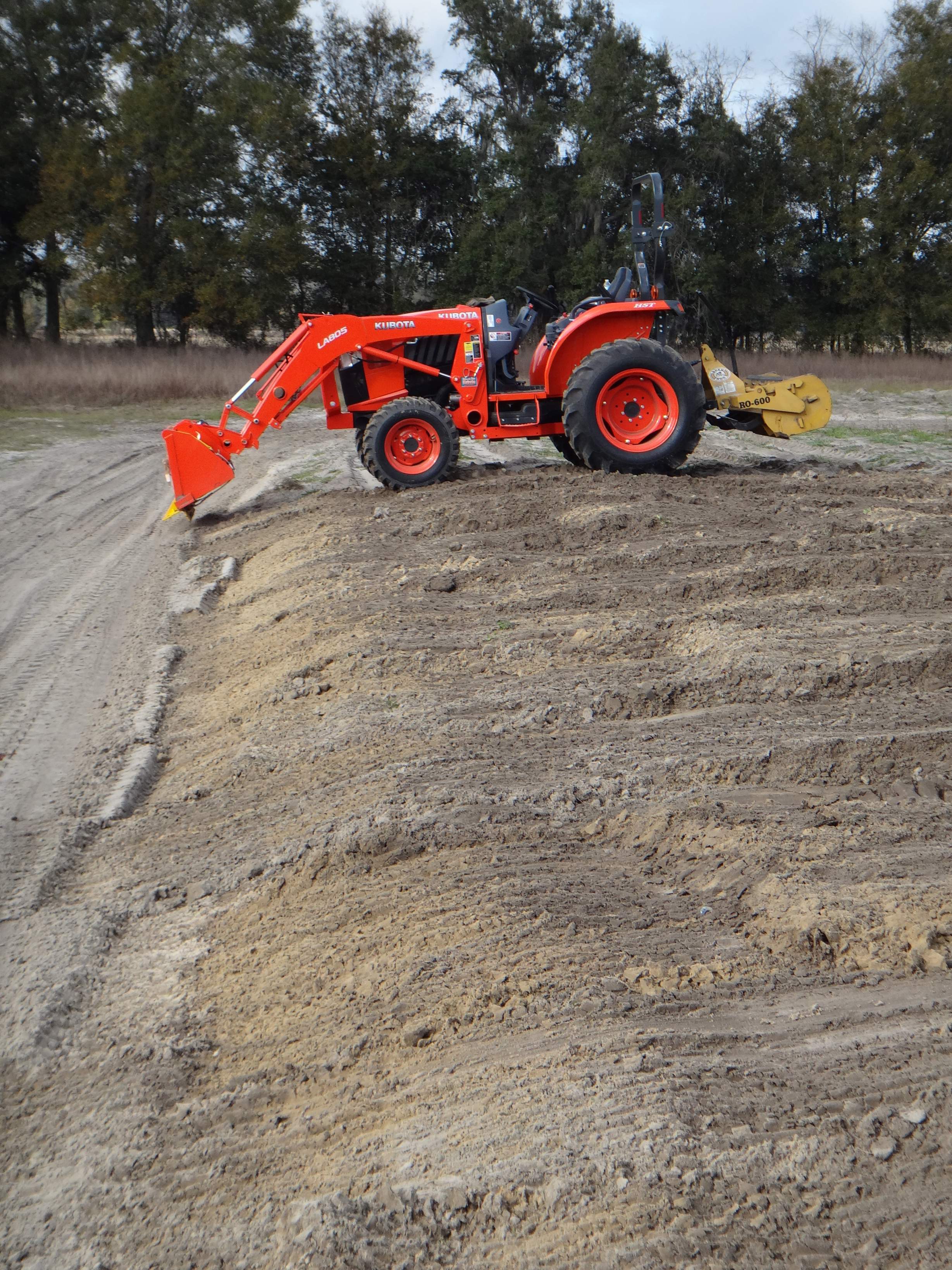

I have an everytfhingattachments.com Category I Landscape Rake, which I excellent behind my relatively small tractor. Excellent quality rake. ETA makes a heavier Category I/II Landscape Rake too: Everything Attachments Landscape Rake, Root Rake
Landscape Rakes are used mostly on an angle, so if you decide to buy, you want one 24" (+/-) wider than your rear tire width, outside-to-outside.
So, yes, you can use a Landscape Rake for all the tasks you have specified however more specialized individual implements/attachments will be more satisfactory.

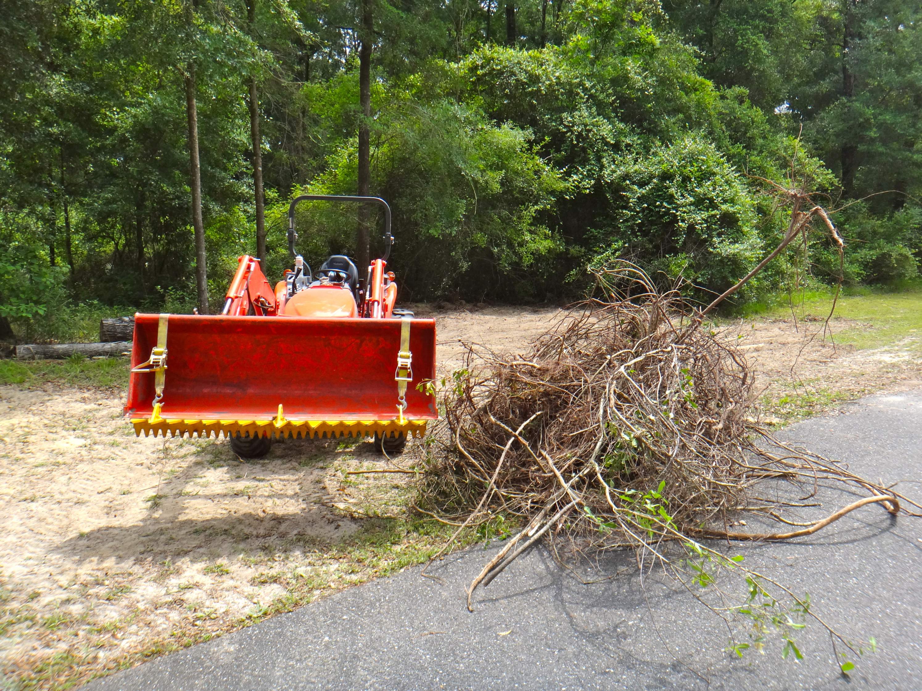

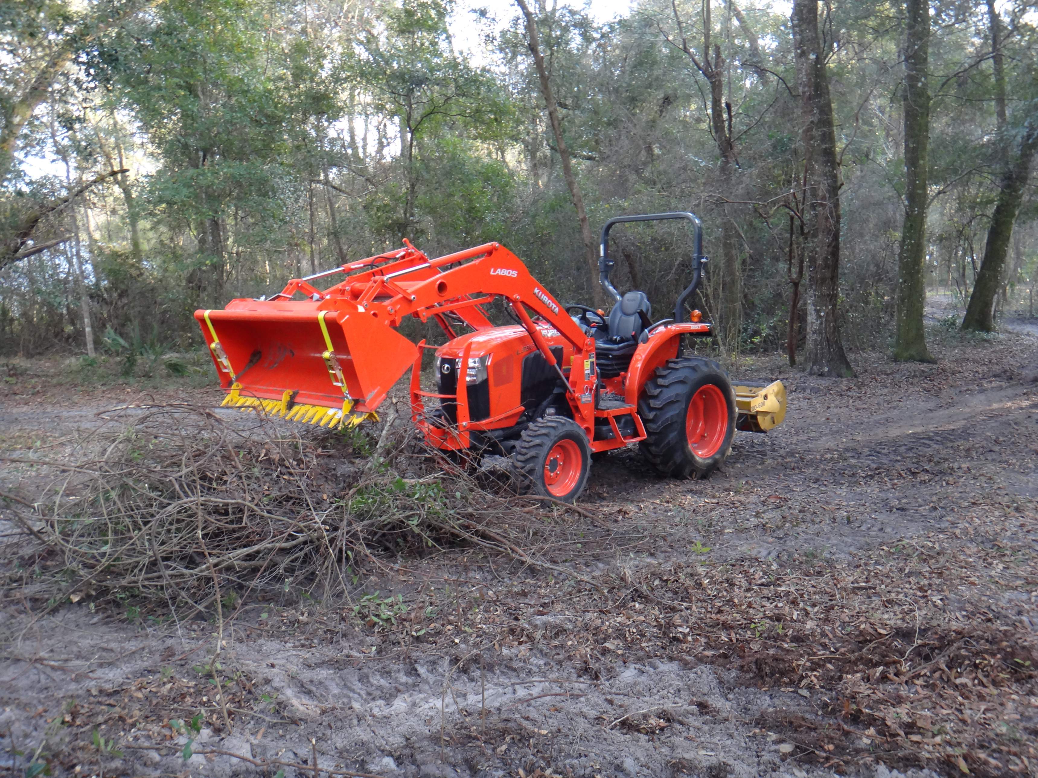

I have found my Ratchet Rake bucket attachment far more efficient for piling brush than my Landscape Rake. It would be equally good collecting surface stones, however I have zero stones in the soil where I am in Florida. Ratchet Rake is also good for minor grading/levelling and unexcelled at tearing out brush.
TSC is a vender for the Ratchet Rake, however TSC is sporadic about inventory on the two larger sizes of Ratchet Rakes. The TBN store, button at top of this page, is also an agent for Ratchet Rake, delivery by FedEx.

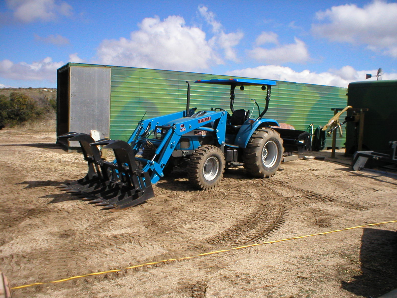

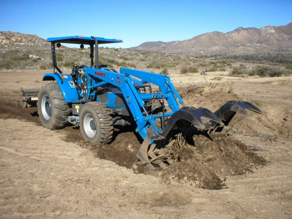

Just my opinion , but this is a perfect time to use a wider (72"-84") root grapple. Sifts & levels the material and picks up material easily for removal. Your tractor is large enough to handle this well.
Works great running the leading edge along about 6" in the ground. First picture has the tines at to steep of an angle, really should be more like the second picture.
I have cleaned up several acres in this manner and it has worked well for me.
