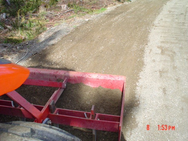

I think you normally want to get a box blade that covers the width of your rear tires. I use a 6 foot boxblade on my Kioti CK35 and that's pushing it. When full and going up a bit of an incline I have to put it into 4WD. I really should be using a 5 foot for the width of my tractor. :)
