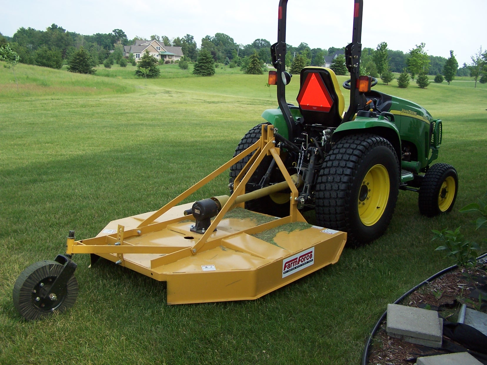

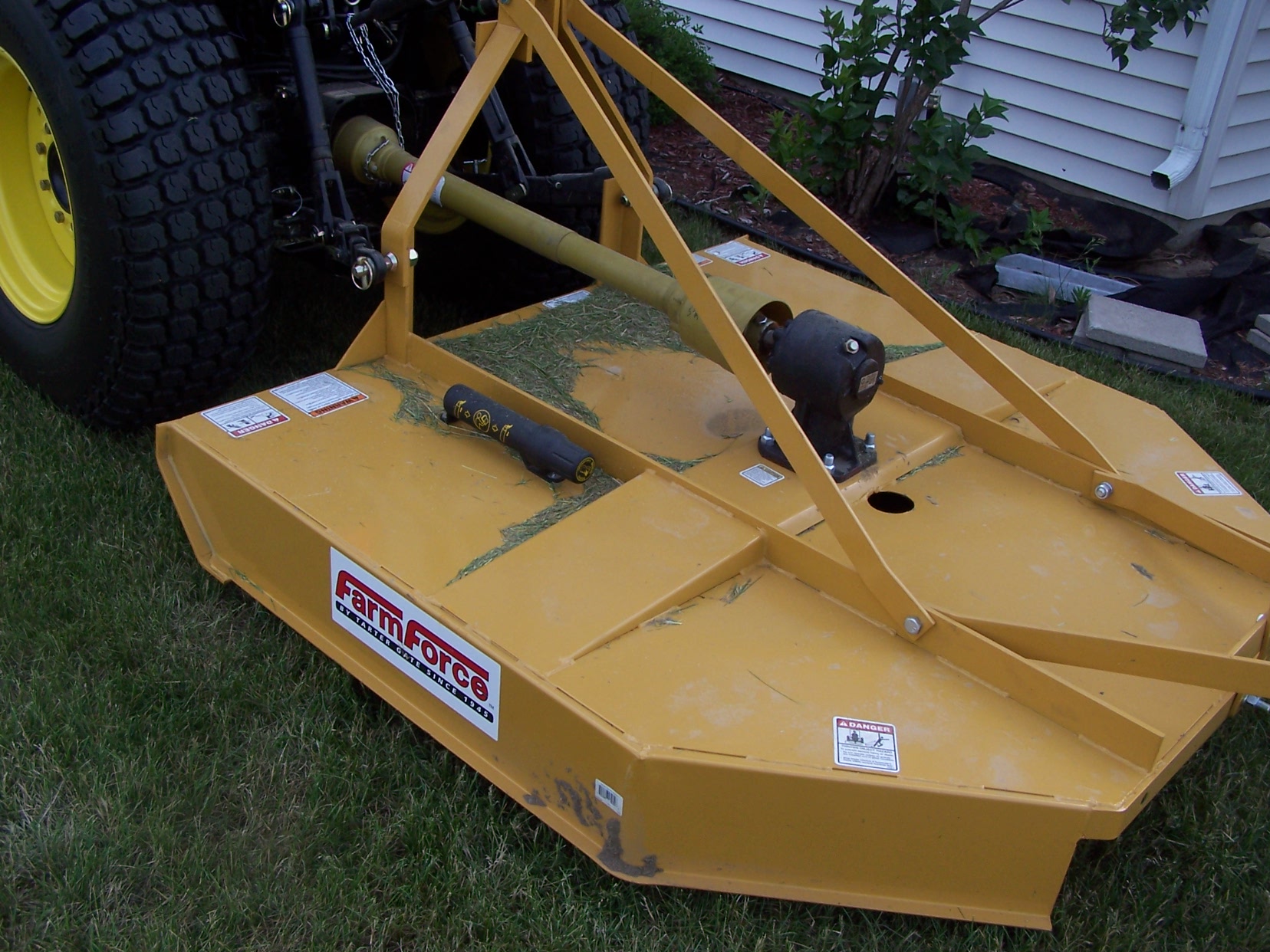

Subway,
I just bought this 5' unit from TSC for $614.79 out the door. That included a $50.00 off coupon that came in the mail. So far I have about 4 hours on it and am quite happy with the way it works. Time will tell on the durability.
BTW: My tractor is 33HP and runs it without a grunt.
Good luck,
KB
