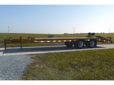

Ok, the verdict is out. You have no idea what you are talking about. You jump into all these discussions and give bad info and tell your wants but you are going way overboard. You have lost total grasp on reality.
A 14K trailer would weight 3,000# or more empty, using most of his tow capacity listed.

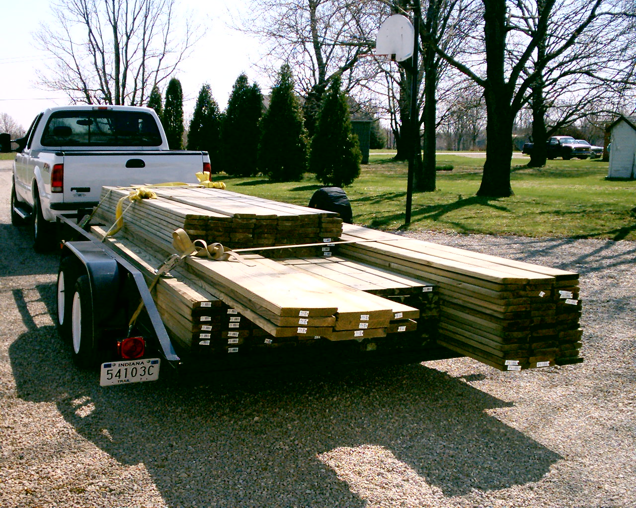

I have a 18' tandem 7K utility trailer that weighs about 1250# empty. I tow cars and my 5,200# tractor on it all the time. I just got done hauling my dads Corvette and also last fall made a 700 mile trip with a Lincoln Aviator (basically a Ford Explorer) in tow.
You need something like I have in this picture. It is 18' but you could get by with 16'. Very versatile trailer.

   / Is 3500 enough? (or how much trailer for a BX?) #10
You need a 16 foot 14000 pound trailer with 4 brakes.
I'm looking for a 1 ton SRW pick up to tow my BX23 with.
Wouldn't something like this be better :rolleyes:
