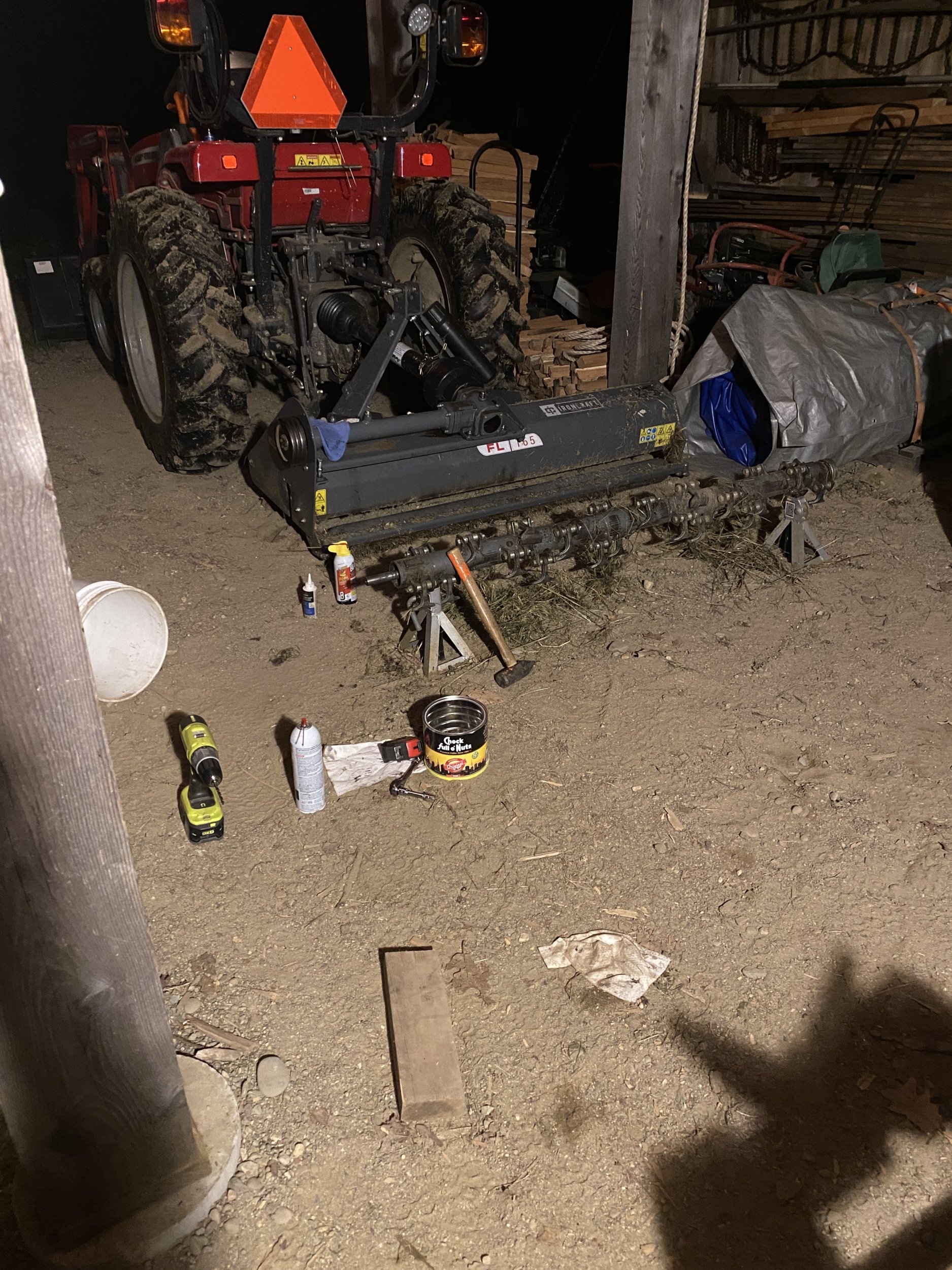

I recently found an opening in the never-ending rain to do some field mowing with my new flail and sure enough had my first failure (this is perhaps my third real use of the machine). I was mowing between a wood-line and a garden and managed to find an old garden hose someone abandoned there. The hose wrapped around the rotor and before I could react/realize what was happening I had already smoked the belts. After some internet research and failing to cross the belt numbers to anything remotely standard/readily available I threw in the towel and went to the dealer to find they are charging about $41 per belt (the flail needs three). I bought six belts and came home.

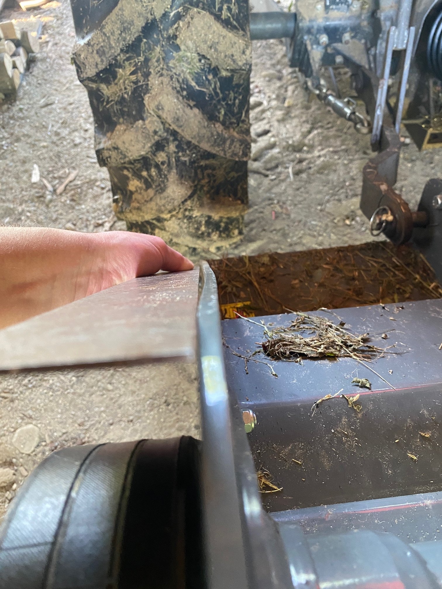

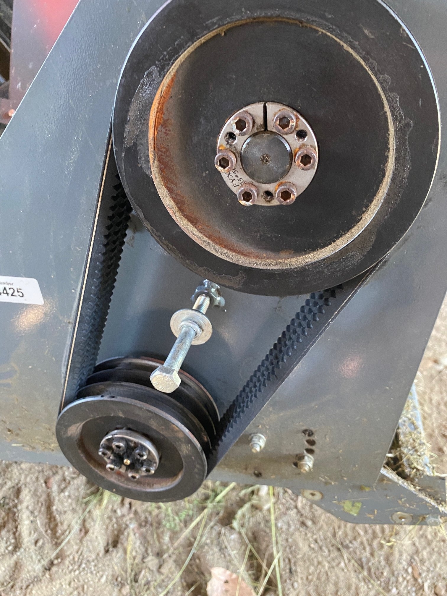

Tonight I started the process of changing the belts and noticed a slight bend in the side plate on the mower. I've never run into anything or otherwise exposed the mower to enough trauma for that to have happened since I bought it (new this spring) and I can't find any indication of the bend being anything other then a manufacturing imperfection. That being said, I checked pully alignment and found them fairly out of line. I started to loosen the drive pulley and found the cap screws on the power-lock "collet" to be barely hand tight. I re-aligned the pulleys, tightened all the cap screws (found those on the driven pulley power-lock to be loose as well) and began to install the belts. I found the first belt very difficult to "walk" on to the pulleys but this didn't surprise me too much based on the limited room for adjustment on the pulleys. The second belt went on noticeably easier and I was almost able to put the third belt on without "walking" it. I took all the belts back off and compared them as best as I could and found that they did appear to be different lengths (I know with the drive pulley assembly loose there could be misalignment or "toe-in" if you will that could make them seem to be progressively looser so I scrutinized this). I went through all six belts to find the three that were closest in length and noticed one of the belts the dealer sold me is a different brand then the others.

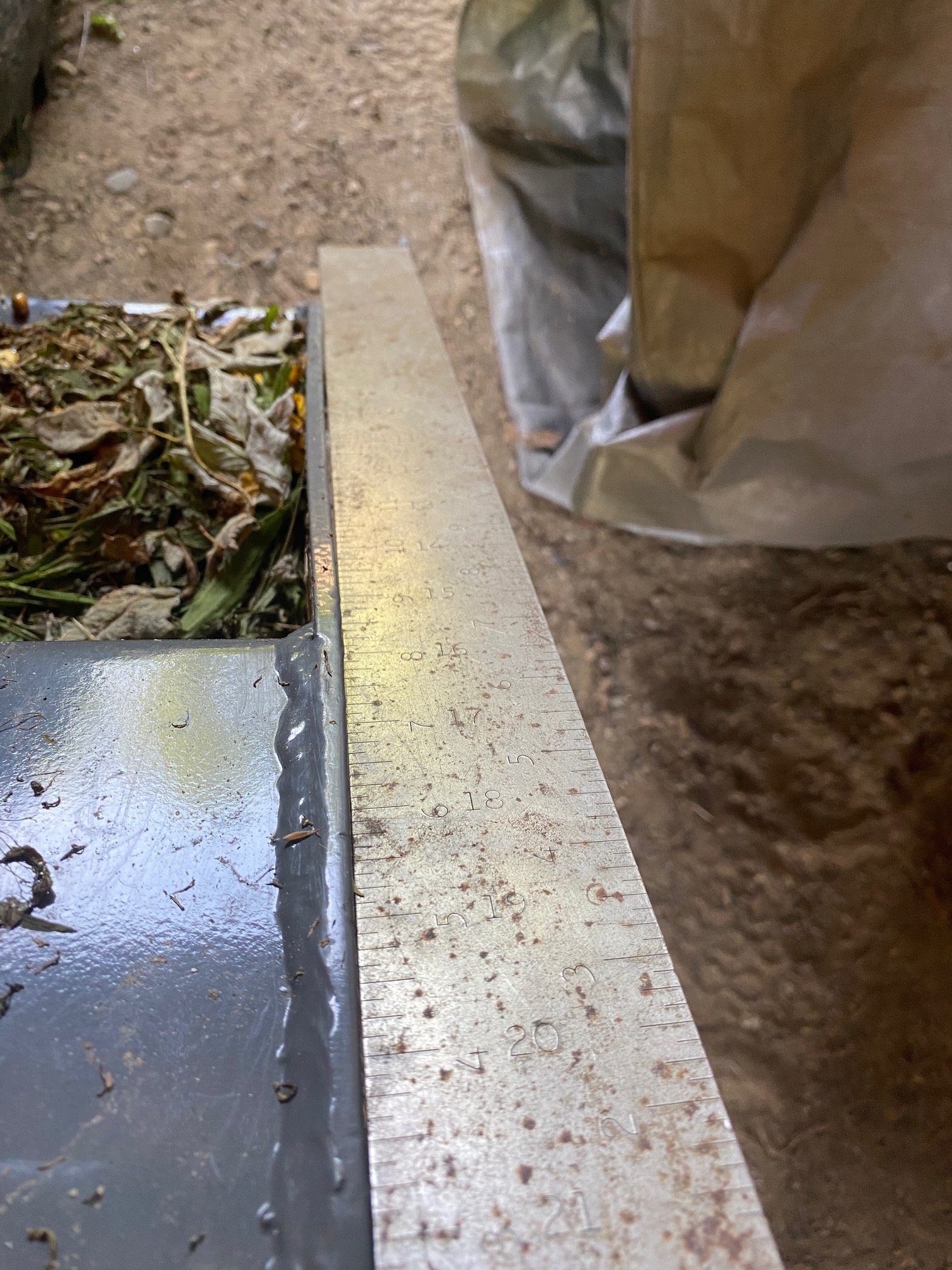

Yes, everything I describe is after eating the hose. You may be right, but I have a hard time envisioning the hose creating enough resistance/torque to warp the side plate without damaging something else as well. I took another look at it this morning and I suspect the warpage is a product of heat distortion from when they welded the plate to the side of the body. I'm sure the welds were done in a single pass without a whole lot of regard for heat control (I'm not criticizing it just would make sense given the thickness of steel and lack of any need for the side plate to be completely on-plane). I did look at the opposite side plate and found warpage there where the plate is free to move/as you get further from the welds. Photos attached for the curious.

I wouldn't worry about the side plates. They don't need to be all that straight.

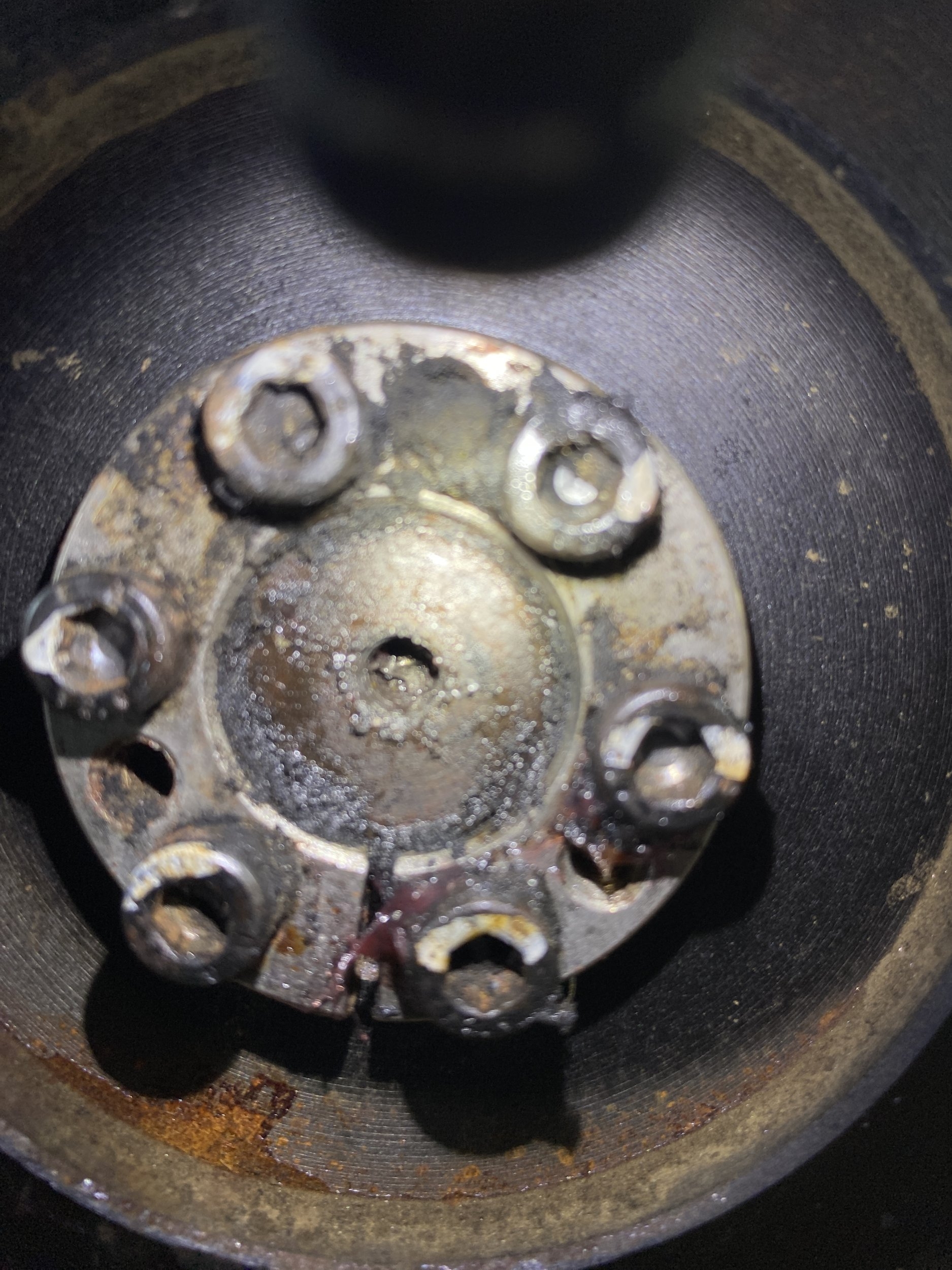

So, I installed the new belts and did a quick fluid check and greasing. Found the grease fitting on the driven pulley side wouldn't take grease so I decided to remove and inspect/clean it. It all but fell off when I put a socket on it. Threads completely stripped. I was irritated but figured that I'll just chase the threads with a tap. Sent a tap in there (by hand) and promptly bottomed out and pulled all the remaining threads out... I look in the hole and found a broken tap in there from manufacturing! Ruined grease fitting now explained. Dealer says 50/50 chance Ironcraft would go good for it and if they did, they'd simply send a replacement part (which would be the whole rotor). So I weigh my options and fix what I have given either way I'm removing the whole rotor on my own time/dime. I managed to drive the old tap deeper in the grease channel (was getting nowhere with removing or drilling it out), removed the rotor, stripped the bearing off, and verified grease flow around the tap to the bearing. When I inspected the opposite bearing I found a set screw floating around in the grease! There is no part that needs a set screw on that end so who knows where that came from! End result: I put it back together and mowed a couple acres without failure.
I may still try for a warranty claim but I don't hold out much hope. Waiting around for weeks to wait for a claim denial seemed foolish when it would be more work on my part to replace the rotor all together. Besides temporary rage at the situation and extra hours of effort, I guess all's well that ends well but I'll be thinking twice about an Ironcraft implement in the future which is a bummer because I've been a fan until now.
