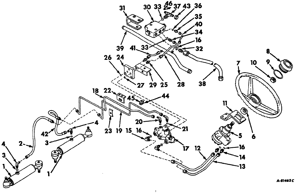

Anyone happen to have a picture of this?
Today got a hole in this hydraulic hose. I made the assumption that it was just old and worn out. Only after I installed a new hose did I realize that the hose is being pinched by the nut on the cylinder end at full lock right.
I probably won't get long life out of the new hose installed the same way. It would be great if I could see what the original installation was like. I can't imagine it coming from the factory that way. Some previous owner coud have used an off-the-shelf replacement that was not the same as original.
   / Int'l 444 left steering cylinder hose routing? #2
I don't know if this will help, but here is the exploded view of the steering assy. from the Case/IH parts site.
