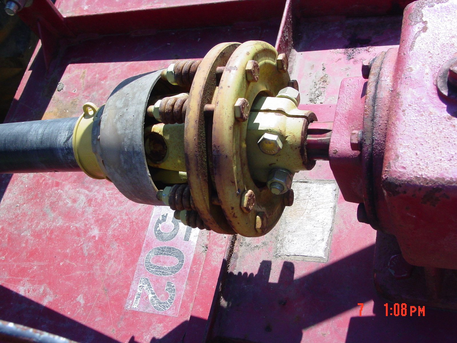

I just bought a 10' international rotary cutter. It looks like it is build well. Is international usually a good peice of equipment? Why do I need a slip clutch and where is the clutch located?

The slipclutch serves to protect the PTO of your tractor by "slipping" when the mower blades hit something solid. This shock isn't transmitted up into the PTO of the tractor. It's often used in place of a shear bolt, the difference being of course that the shear bolt must be replaced each time it "works" but the slip clutch should almost never need replacing. A slip clutch is usually installed directly on the input shaft to the gear box of the mower, but it could be different on a mower that has two gear boxes. See the pic of the slip clutch on my 5ft International Machinery IM502 mower.
