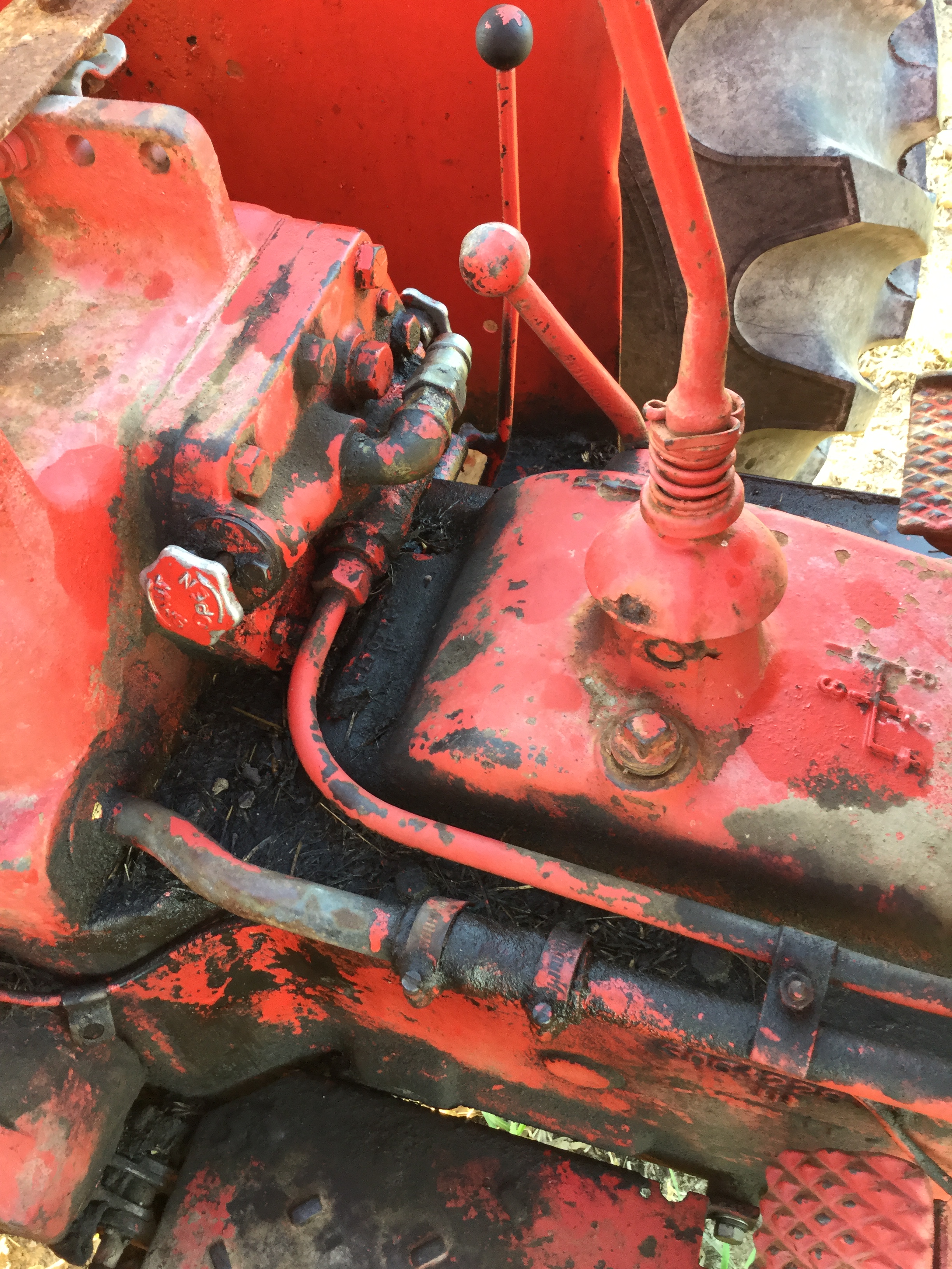

Hi All,
An AU A414.....below is an image, I know the high/low and gear shift, what is the lever at the top for ?
And at rear it has an Hydraulic out or return, and you can see one near the taps, not sure if that is factory ? I guess it needs a hose run round the back if you want a hydraulic top link etc ?
The lever at the top is for the PTO. With the clutch pedal all the way down move the lever towards the rear to engage the PTO. It helps if the motor is at the lowest possible idle speed. If it is still difficult or impossible to engage just move the lever as you are starting or turning off the motor.

Right you are.
I have the machine on hand now, thought it was PTO but as there is a few variants, best to ask......

Got to test the PTO out, it all operates as expected, quite a good tractor for its age.
