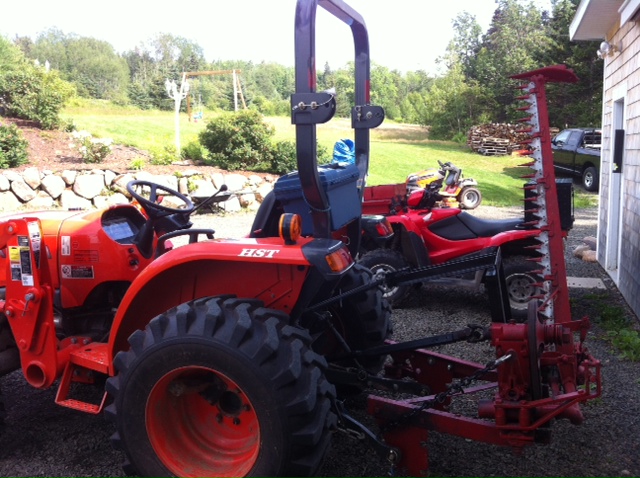

i have a kubota l3800 hst
i grew up in the city, this is the first tractor i have owned, luckily i have a neighbor who taught me the ropes
i recently picked up an old sickle bar mower
from my internet research its an a-21 international sickle bar mower
we are adapting it to fit my 3 point hitch, after 2 days of drilling, welding, and fabbing up some parts, we have it mounted
turned on the pto, everything works, but there is a loud clacking noise that is intermittent, sometimes few in a row, sometimes a few seconds in between noises
i marked the 2 pieces of the clutch (in by the large top flywheel) and ran it, then stopped and found the marks were off
so i determined maybe my clutch is slipping, i tightened the spring on it a few turns, still no change or improvement
also of importance, the knives arent binding and the 2 gear boxes were both bone dry when i found it, but we filled them up prior to use
any help would be greatly appreciated!! tactor1.jpgtracor5.jpgtractor 2.jpgtractor 3.jpgtractor 4.jpg

Something in the sickle is sticking. Can you pull the sickle in and out by hand? If not it is too tight. I would also look at the back of the sections to see if the corner of one may be catching on a wearplate or holddown - sometimes sliding by soimetimes hitting and causing your clutch to slip.
If it will cut the grass without slowing strokes I would not tighten the slip clutch anymore - that is not the root cause.
If you find the sickle hard to move but cannot define a specific problem you may need to loosen it all up and reset them one-by-one.

Sounds like there's a lot of excess friction in the sickle mechanism. Could be a bent bar. Could be that the sickle sections are too tight against the ledger plates in the guards. The hold down clamps on the bar also might be too tight. Check both ends of the bar to be sure they're not hanging up on something.

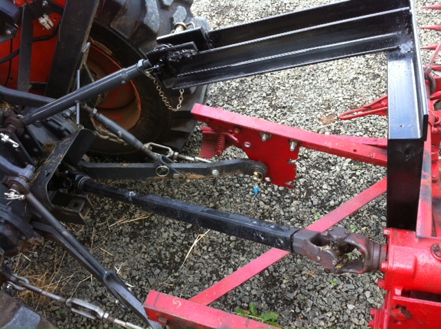

we have the center link rigged up with a chain but it doesnt prevent the mower from tipping forward or back under extreme angles, if i get the lower lift arms up too high
this afternoon we are going to try to fab up a triangle of sorts to mount to the center point link

the mower works
the loose teeth was definetly the problem
fabricated a more solid framework for the top link that prevented it from tipping forward and back on the previous chain mount...
here are some photos, and thanks to all who gave such accurate advice!!photo 4.JPGphoto 3.JPGphoto 2.JPGphoto 1.JPG

That looks like it makes a lot more sense. The fore/aft tilt is critical to cutting - too far forward and it is always digging in the junk, too far aft and it slides over and does not cut.
