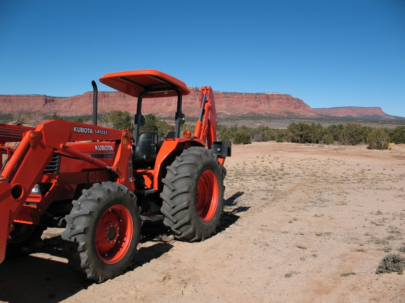

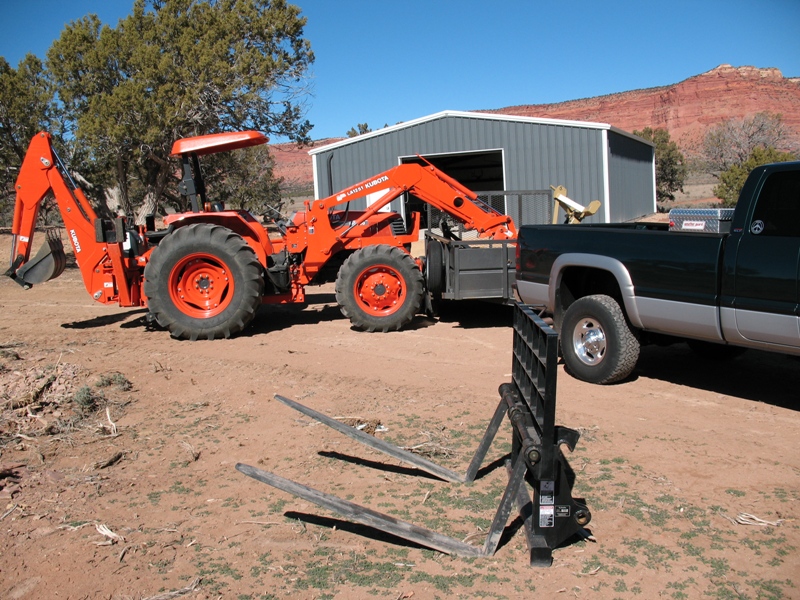

Hi Everyone,
I have been out here reading and obsorbing all this good info. Now I have the opportunity to buy a International 125 crawler loader with a 4 way blade/bucket. The owner is a neighbor of mine and bought the crawler new in 1980. It has about 2950 hours on it. It has been well maintained but used at the same time. He is asking 10.5K for it.
Questions, What should I look for? I have no expierence with this kind of equipment. I intend to use it to grade roads and engage the earth around my property. The ground in my area is either hard red clay or sandstone shale.
I also have a Kubota M9000 with a backhoe but it will not hardly dent the sandstone shale, however the backhoe does a fair job of it.
Thanks

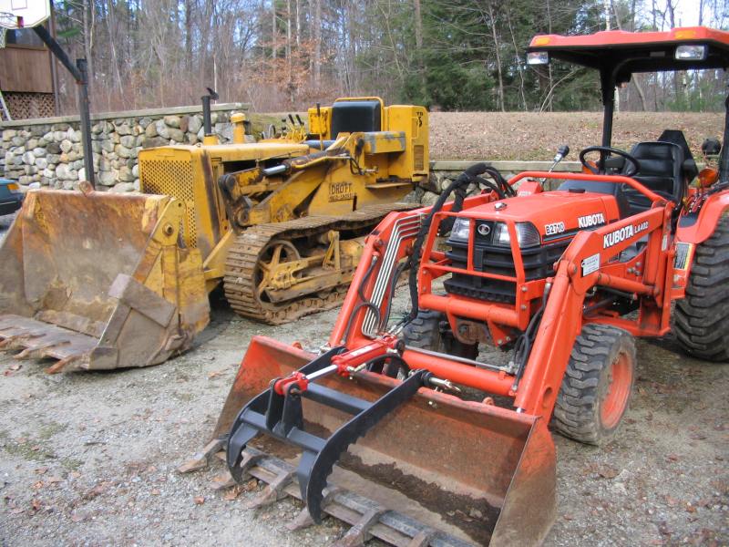

Well, you probably want to go over to the Red Power Forum in the IH Construction Section and ask there. They are the IH experts and can tell you what to look for in the undercarriage and other areas of concern. I also believe that $10.5k is way too much for that piece of equipment.
My IH TD6 with Drott loader and 4n1 bucket is shown.
