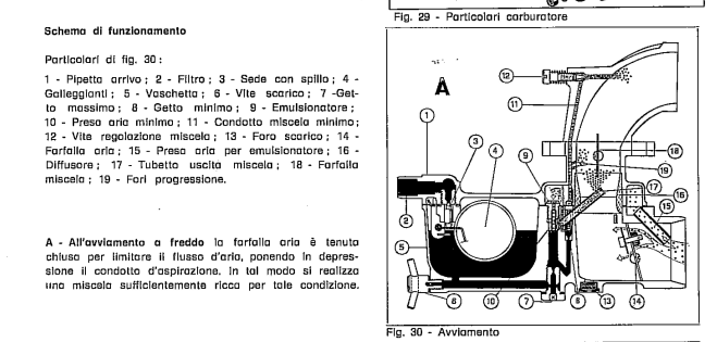

I started taking it apart, but then I got stuck with how to hold the flywheel to undo its nut to check the key. I bought it from a garden equipment service shop in Italy, and the guy selling it told me the previous owner just had used it with the snowblower attachment. That and the fact that there is a problem (which of course I only noticed after I bought it) getting it in to one gear leads me to suppose that the previous owner hit a rock with it. So that's why I started with "gusto" to dig in to check the flywheel key!
I hunted around today and read about the trick of putting rope in the cylinder through the spark plug hole to hold the flywheel. But now I also notice the spark plug has quite a lot of black carbon fouling. Maybe I should have checked that first. But I'm going to go ahead and pull the flywheel and check for that key, now that I'm almost there, and then I can try to google translate the instructions about the carburetor adjustment.
