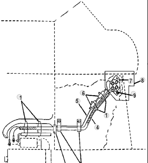

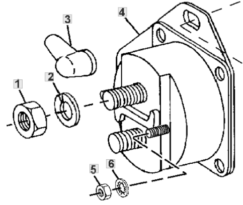

Yrs back JD offered a kit for adding a starter relay to give solenoid activation wire more amps for better solenoid engagement. Failure of solenoid to engage starter could also be pitted contact lugs or washer inside solenoid cap
On subject of circumventing safety features of tractor wiring utilize extreme caution to be 100% sure transmission is in neutral before attempting to engage starter while standing on the ground or have someone sitting in tractor seat!!!
