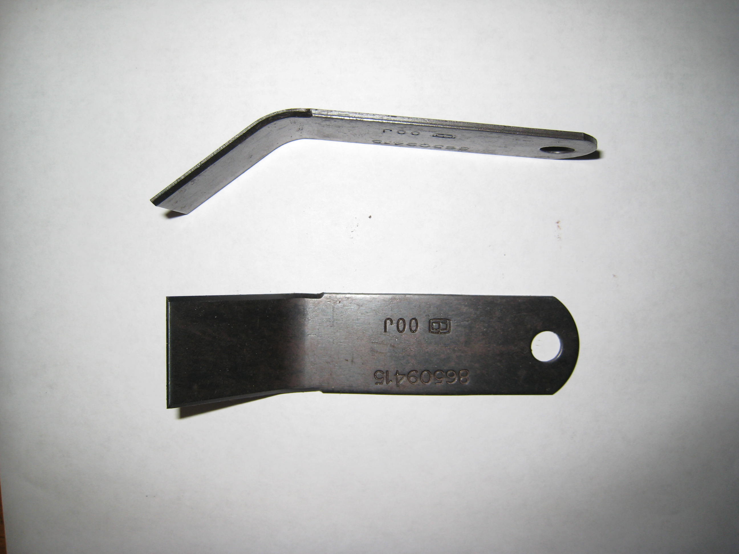

Have used a flail mower for few years now on third different brand. Two were boom mowers used to trim trees and limbs mostly. My thinking here and never had a need to make a change like you are considering. The flail or hammer weight and the speed they are made for comes into the diameter of the hole for them. If a company designed theirs for the 5/16 bolt and you use the grade recommend would think you are fine. Only negative can think of is it might wear the lug on the rotor in a narrow radius compared to the 3/8 bolt so would watch for that. Does the 3/8 bolt fit tight in the lug radius? I think to drill the flail itself you might be removing metal you need there and would not want to.
New 3/8" bolt fit is somewhat loose in the rotor lug holes, until they are torqued up and it looks like they have stayed nice & tight for many years in my mower.
My flails are possibly original and pretty worn so I am looking for options of replacing all 96 of them.
Because of $11.66 ea price the OEM fails are not really feasible, but the Alamo/Mott ones are somewhere under 2 bucks which would be fine.
I don't think removing small amount of metal by making the hole from 5/16" to 3/8" will be a problem at all, since they appear to be otherwise identical to the original Ford flails.

Here is what a new OEM flail 86509415 looks like:

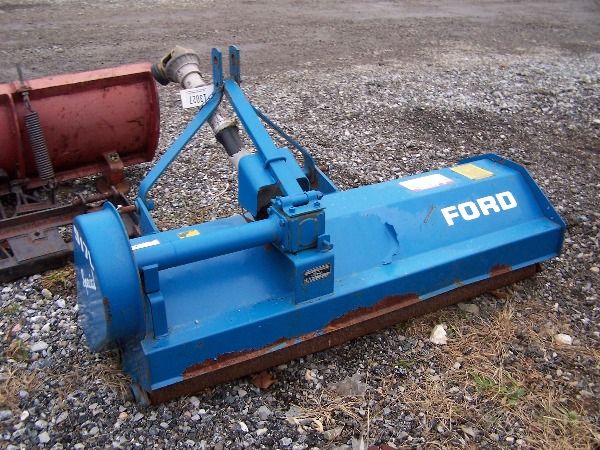

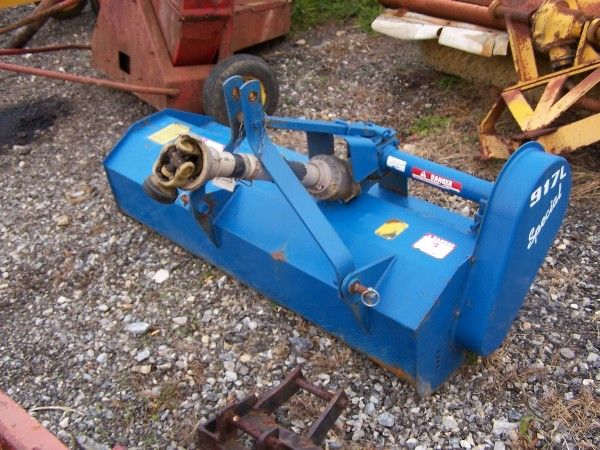

Here is a mower just like mine:
