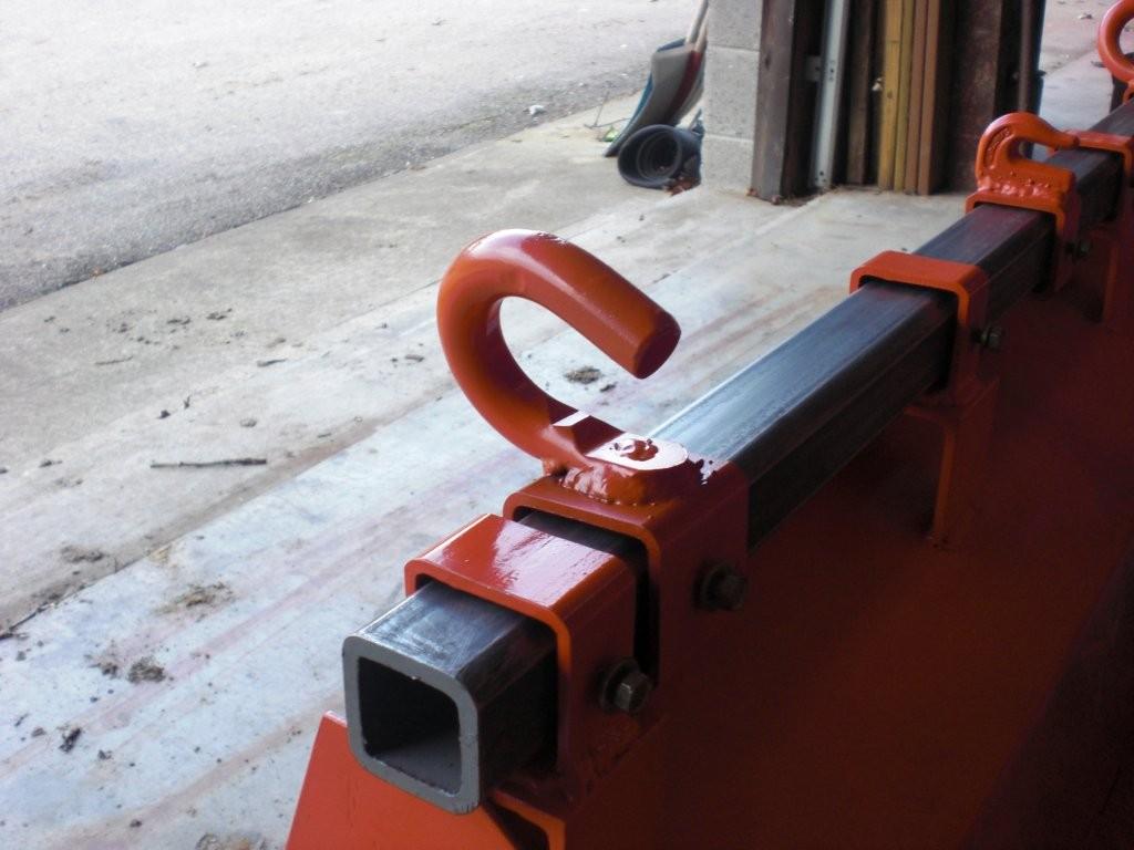

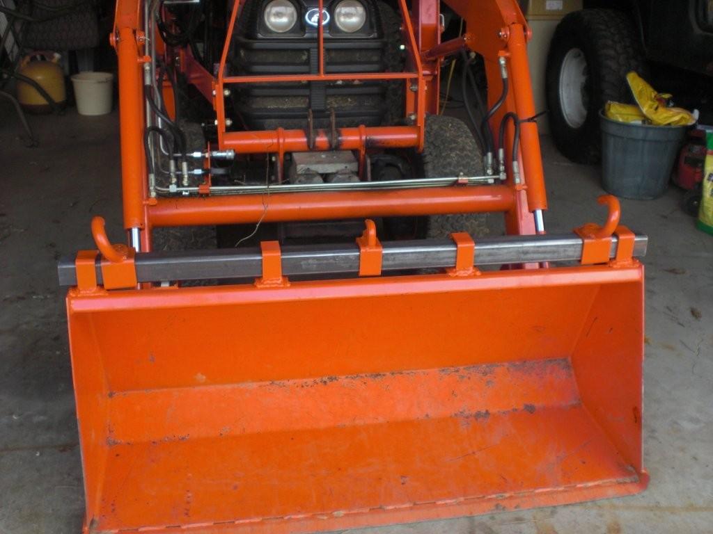

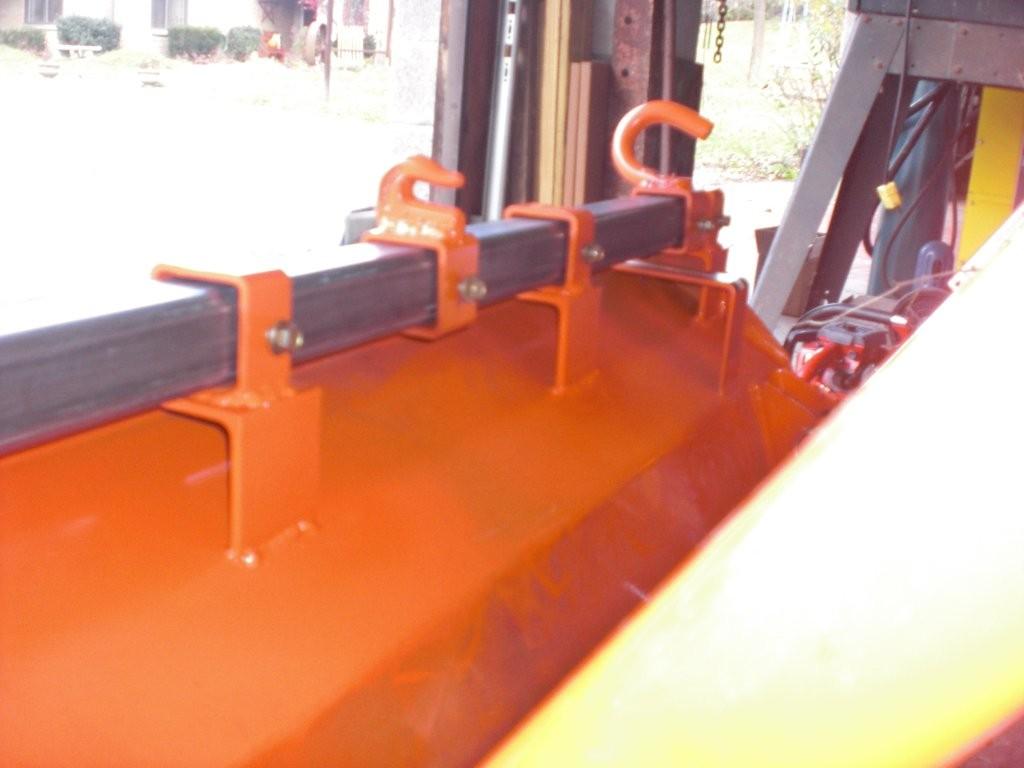

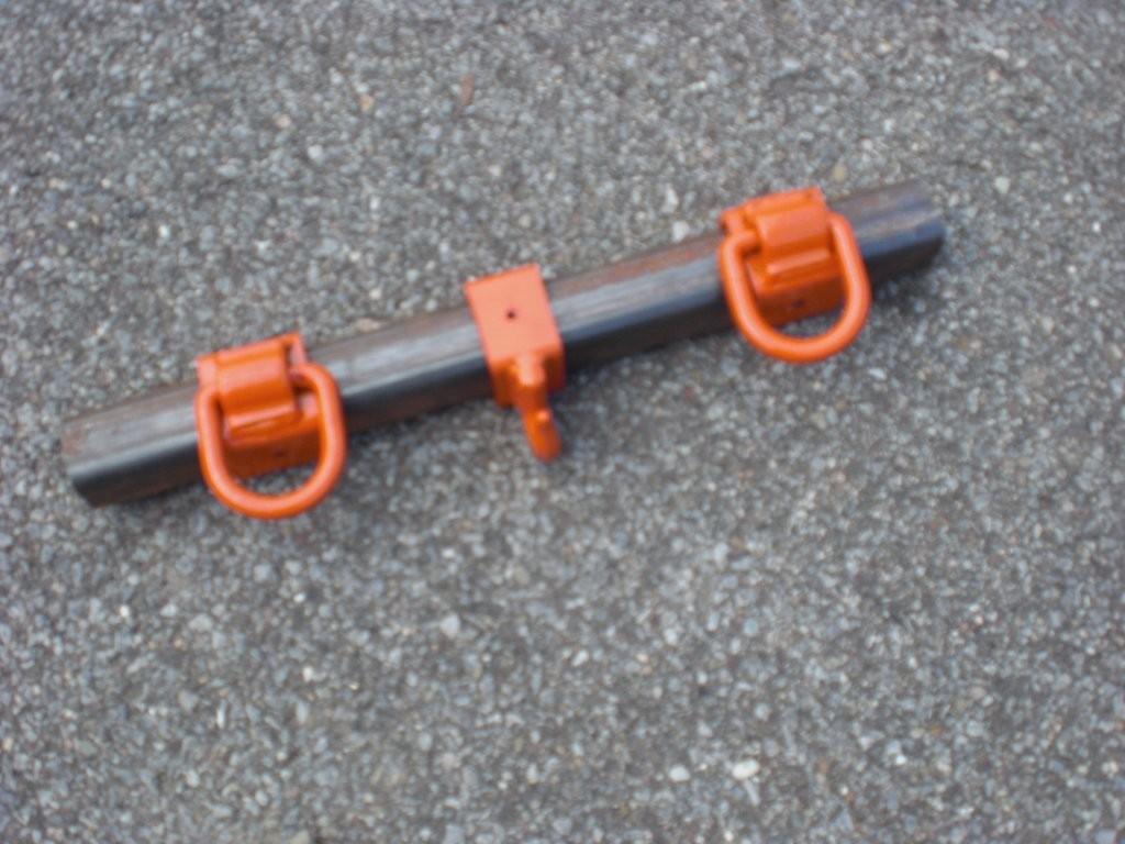

Here are a few pics of my bucket hook solution, I mounted 4 pieces of 2.5" square tubing to the top edge of my bucket. I then got a thick wall length of 2" tubing the width of the bucket, I then made a couple of hook adapters. I used weld on 5/16 chain hooks, D-Rings and large tow hooks from the front of S10 Pickup for hooking straps to. I dimpled the 2" tubing in the center and directly in front of the cylinders for easy alignment. I drilled and taped set screws in everything so they fit tightly and don't rattle.

Don, that is great! Very ingenious.
   / Interchangable Bucket Hook System #3
It is a neat solution, but I would wonder about the leverage effect on those large tow hooks being several inches away from the bucket? Probably won't be an issue for normal use. Good job, though!
The little bar does fit but I don't plan on using it, I think you would have more of a chance of bending the bucket using only 2 of the supports. As for the leverage it would have been nicer if I could have mounted it below the lip of the bucket which would have lowered it about 1.5" but since my FEL capacity on my small machine is only about 1000# I'm sure I would max out the FEL before I break any hooks

I like it, I like anything interchangeable and universal, another good use of 2x2 hitch tubing. With something along those lines you could have an easily removable grapple.
JB.
Yea, as soon as I saw what it looked like when I finished it I imagined how easy it would be to attach something like a "Thumb"

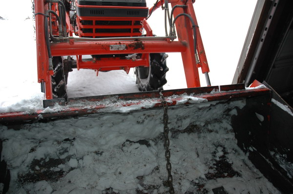

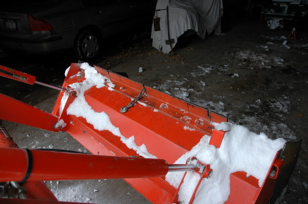

Not sure how well this shows but before I could weld this is how I made chain dogs for the top of my bucket. I also wanted to reinforce it since I'd seen too many overtorqued bucket tops that were bent and I didn't wnat to chance that. Just use a piece of 2 inch angle iron, bolted it to the top, and cut some notches with an angle grinder. Chain slips in either direction so you can life from front or back.
