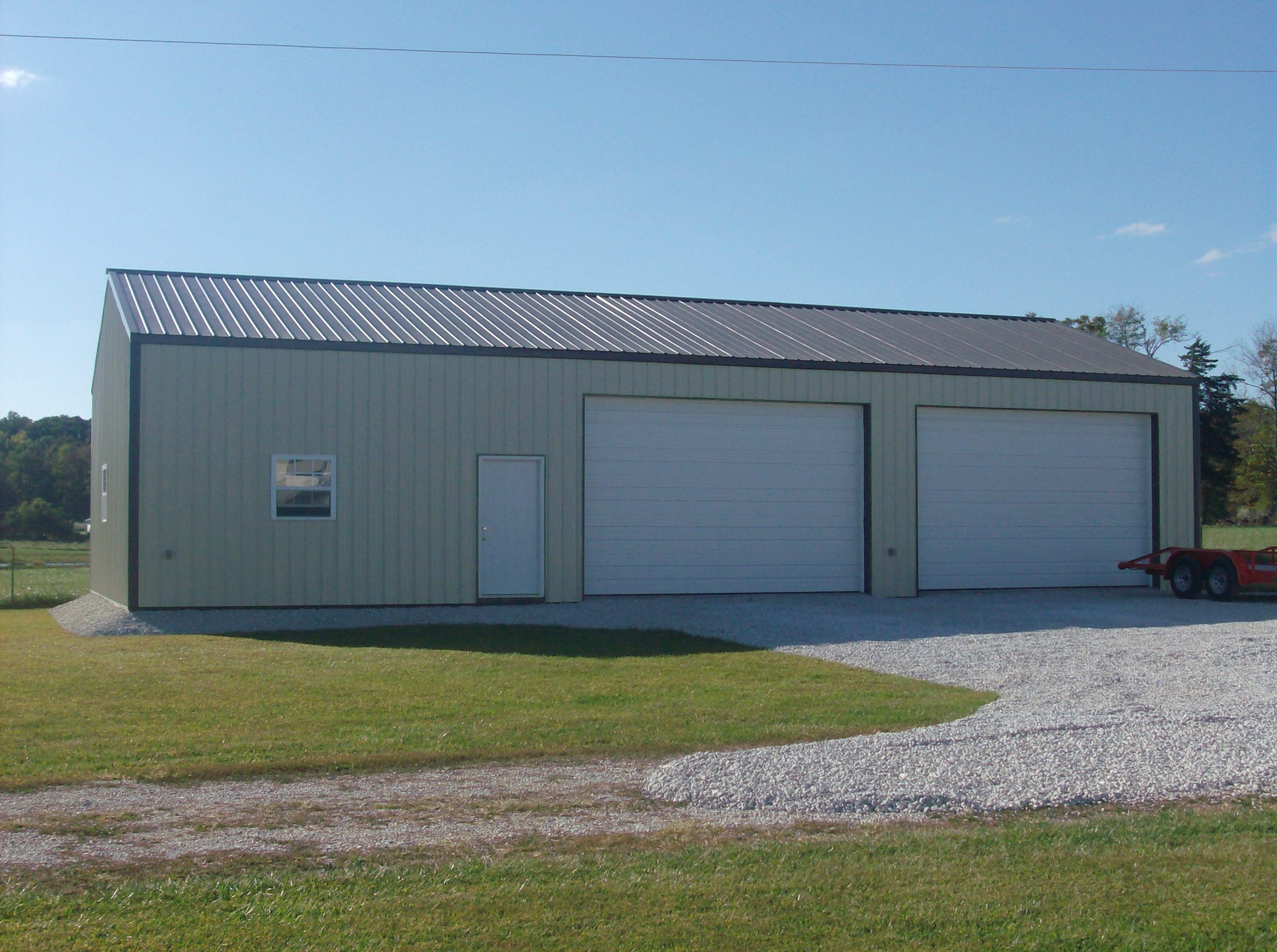

When they built my 30X60 shop it was insulated with 1/4" bubble wrap shiny side out and white side facing in. Metal siding was then installed on top. It made for a comfortable work space both in winter and summer with minimal heating and cooling. I had them install a full length vented ridge cap to keep the air moving. I installed two 10X16 overhead doors that were also insulated and powered which was very convenient. I have had no problems with moisture which was a concern because of my shop equipment. I live in Missouri which probably doesn't get as cold as Nebraska, but humidity can be a problem. So far so good. Mike.
